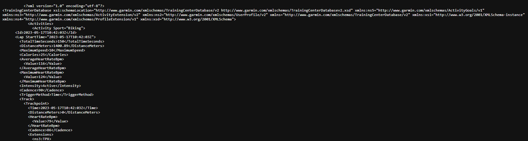

My TrainerRoad workout normally syncs from Strava to intervals.icu with no issue. Today, it did not. I downloaded the tcx file from Strava, but intervals.icu will not allow me to import it because it is too large. I downloaded the fit file from TrainerRoad, but it is all non-English characters and intervals.icu does not recognize anything in it, only grabbing the workout title and nothing else. What’s happening here?

When I drag the TCX file onto the calendar, it just opens a new browser tab showing the following:

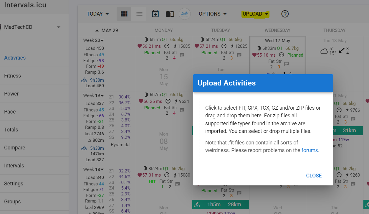

If I try to add a ride and use the “import” button, it gives an error about max file size like this (I am using tomorrow’s date since I now have the workout synced from Strava on today’s date):
That’s the dialog to add a workout structure or manual activity and the like.
You need this to add activity recordings:
