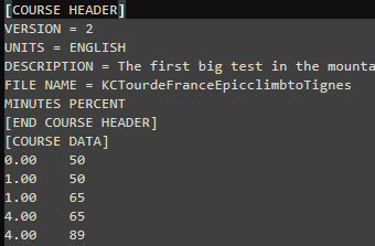

Converted in .mrc
as you can see, they are dot and a number after the % of FTP
2nd example
A workout created with the % of FTP
The .mrc conversion gives me again decimal numbers on the % FTP
So, I wanted to upload these .mrc file in the ergvideo software and unfortunatly it made the software crash.
I finished to find the solution when I manually modified the .mrc file to delete all the decimal values of the % FTP
And now i can upload my workout in Ergvideo and play it with the accurate values.
Is it possible to fix this problem ?
I mean, the .mrc conversion gives only the FTP % without the decimal part.
I tried to create the same workout on Trainerday and the conversion to .mrc gives the right number of % without any decimal number
I have updated the MRC file generation to not use decimals on the % ftp values unless it is required. Also if the workout uses % of ftp (and not zones etc.) then the percentages are used as is instead of being converted to watts first.
ok. I have just created a new workout and convert in.mrc to look.
The % of FTP is correctly convert.
The problem of decimals only appear when i decribe a step of the workout like a zone.
And as you can see on the .mrc file, the Z1 is converted by 49.1 %
So, I upladed it on Trainer day. As you will see, TD ignore the decimal part
Also, to test, i upload in the ErgVideo Software and there is no crash.
Eventually, are you interrested to get the crash logs of my previous .mrc files upload on ErgVideo ?

I can’t really get rid of the decimals because I added them in response to a user request long ago. Maybe you could find other free software to run your trainer? One that accepts ZWO files would be best. I am sure you could find some if you search these forums or ask.
