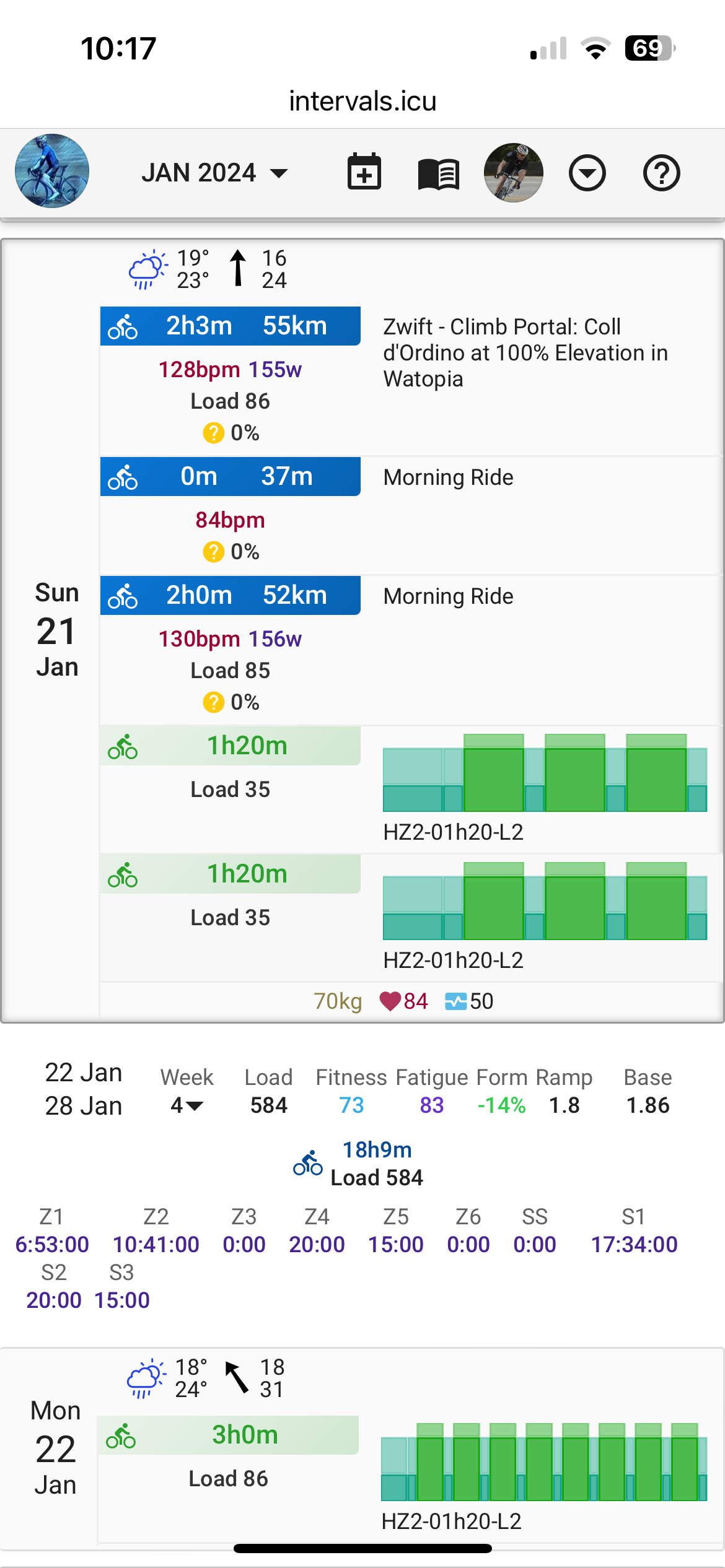

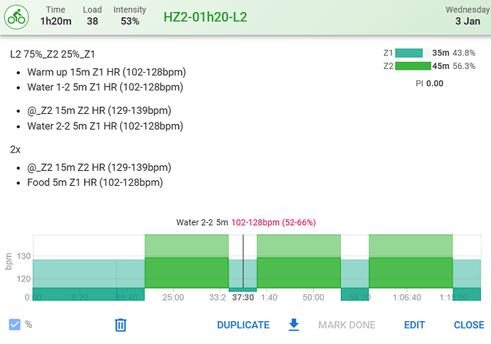

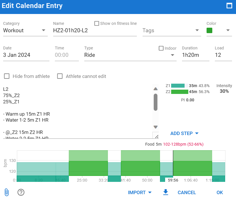

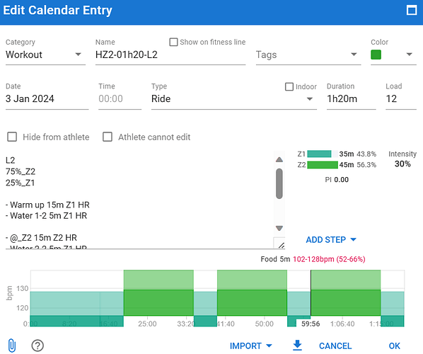

The chart is completely screwed and load shows one thing before opening the workout for editing and another thing after …
Any ideas? this is happening to only one guy that I help. tks.
Load of 38
Same workout but load of 12…

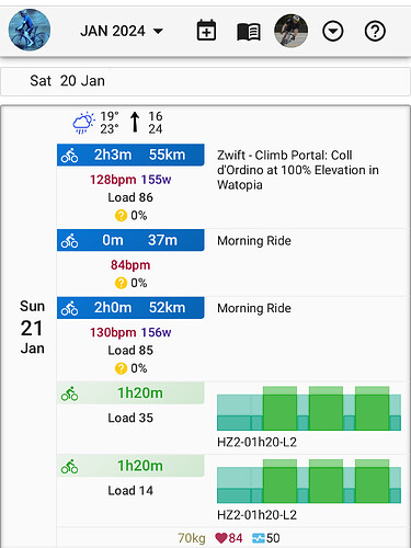

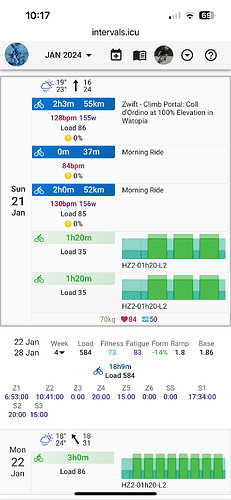

Fortunately I had taken a print to demonstrate it
Two exactly same workout one showing a load of 35 and the other 14 …
But when I open one of them it became 35.
Now both are showing 35 ( which is the correct figure)
Not only that … now all of them are showing correct figures.
The workout:
L2
75%_Z2
25%_Z1
  • Warm up 15m Z1 HR
  • Water 1-2 5m Z1 HR
  • @_Z2 15m Z2 HR
  • Water 2-2 5m Z1 HR
2x
  • @_Z2 15m Z2 HR
  • Food 5m Z1 HR

Hi David,
I might’ve found the what was causing it, resting heart rate provided by Garmin. It was jumping all around…
I asked him to uncheck sync of it and we set a fixed one for while.
It kind of solved but I had to enter each one of the workouts in order to get recalculated .
Was that it?
Tks
Aha. Yes it is very likely that was the problem. Intervals.icu needs resting HR to calculate the load. Thanks.
