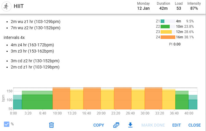

With the help of @Roberto_Viola I have been able to get QZ installed on my NordicTrack Commercial 2450 and linked to my intervals.icu so that my planned workouts are showing up on the treadmill and can be executed on the treadmill easily. However we are running into one issue that may be with the way I am building the workouts in intervals.icu or with how it is sending the data to QZ. Below is a snippet of a workout, I try to train in specific HR zones. QZ knows these zones, and tries to adjust the workout (speed) based on this. However it starts at 1.0 mph and moves up by 0.1 mph every 10 seconds, so effectively I never get in the right zone since it takes forever. Is there a better way to build these workouts in intervals.icu? Is there a way to have intervals.icu send over a starting (estimated) speed for the HR zone instead of 1.0 mph?
Just an example of how I write my workouts:
Thank you

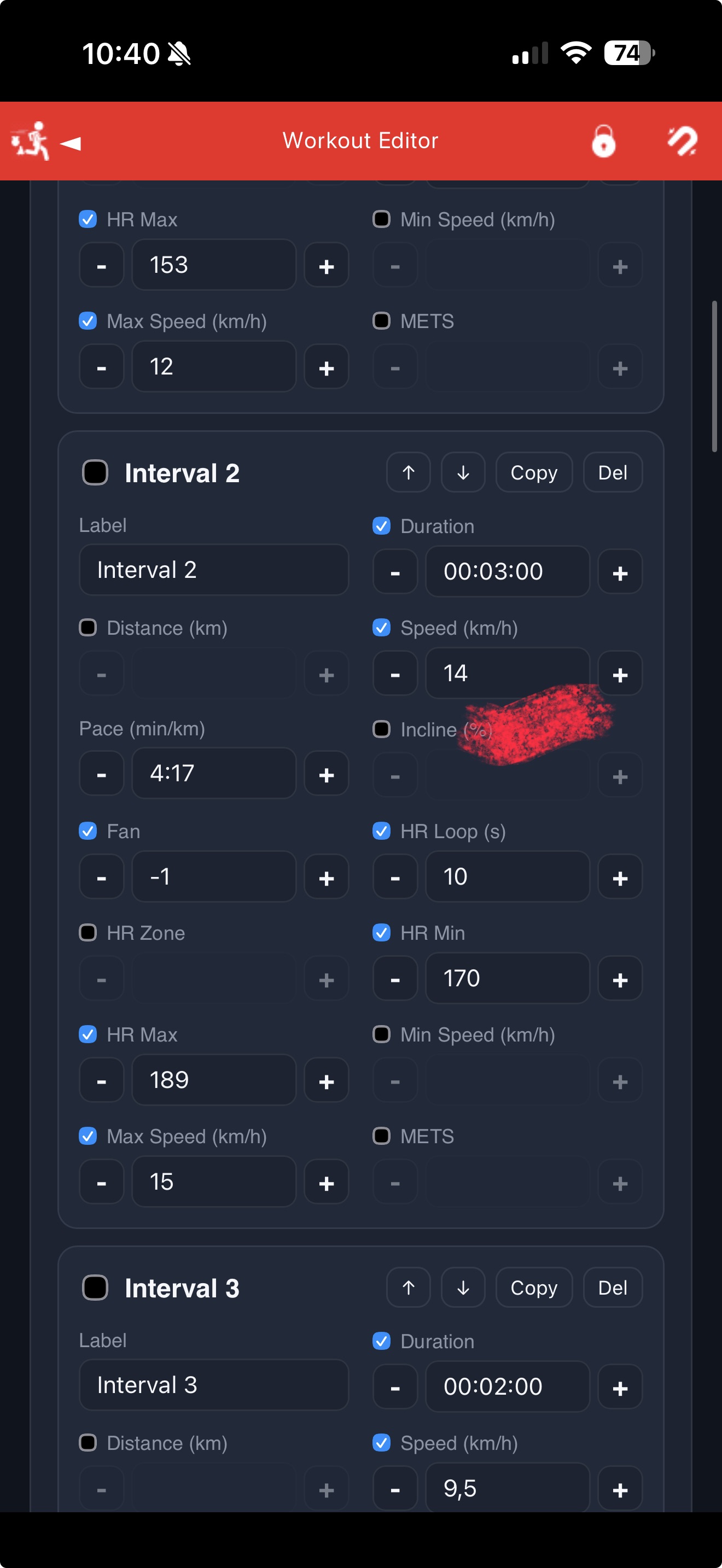

Qz developer here. Qz has a workout editor to do so like this
But it would be nice if intervals.icu does this directly from itself so QZ can download directly from the intervals.icu integration

Yes but pace intervals are different from heart rate ones. We just need to specify a standard tag for the HR workouts. Qz did it in the xml setting hr min max and loop pid timing

Maybe you can add an option in QZ with a starting speed / resistance for every hr-zone?
You can do already with the workout editor in qz
