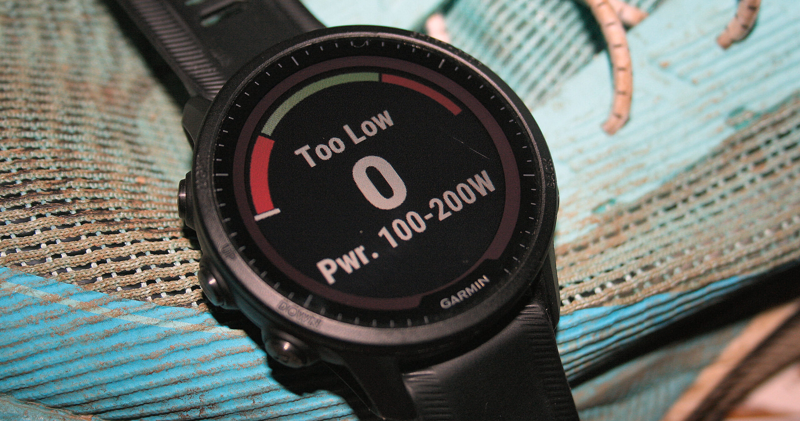

At least on my Garmin Fenix 5x workout screen either you have power target ( a range) or hr.
I can not even change any those field: we have Target range (gauge) , speed, and step time.
I wish could at least change speed for HR or pw or vice-versa.
I’m not sure about other devices.
tks,
Structured workouts screens like this one the Fenix 5x Cannot Be changed. this is a default setup screen.
You can only change your own custom data screens / fields.
Also - the fenix 5x cannot connect to the trainer and control it. It can only read the power numbers from it
