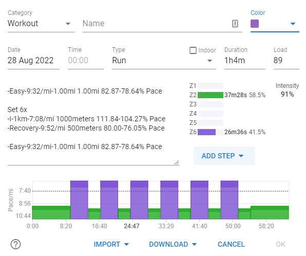

Workout from here:

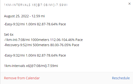

Workout in Garmin pushed by Intervals.icu:
I had not notice until looking into this issue, but if look at the second line of that screenshot with the date it has the incorrect total distance of 12.59 miles instead of 7.59 miles (increase of 5 miles which makes sense on how Garmin seems to be reading the workout).

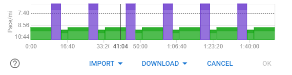

How Garmin interpreted the workout:

When you paste one of the “bad” workouts from Excel into the Intervals.icu workout builder does the issue occur?
Yes, but only for the workouts with intervals. The workouts where it is just a warm up, run, and cooldown I have not seen any issues.
I have done some testing and have figured out that because I have merged columns from which I am copying the text for the workout from, Excel inserts tabs for each “blank” column. This causes issues for either how Intervals then creates and pushes that workout to Garmin or when the workout is passed to Garmin, Garmin does not know how to interpret those extra tabs. I am not sure why it only effects workouts with intervals and not all is a bit unusual, but I am guessing it is due to the two (2) blank lines within the workout.
