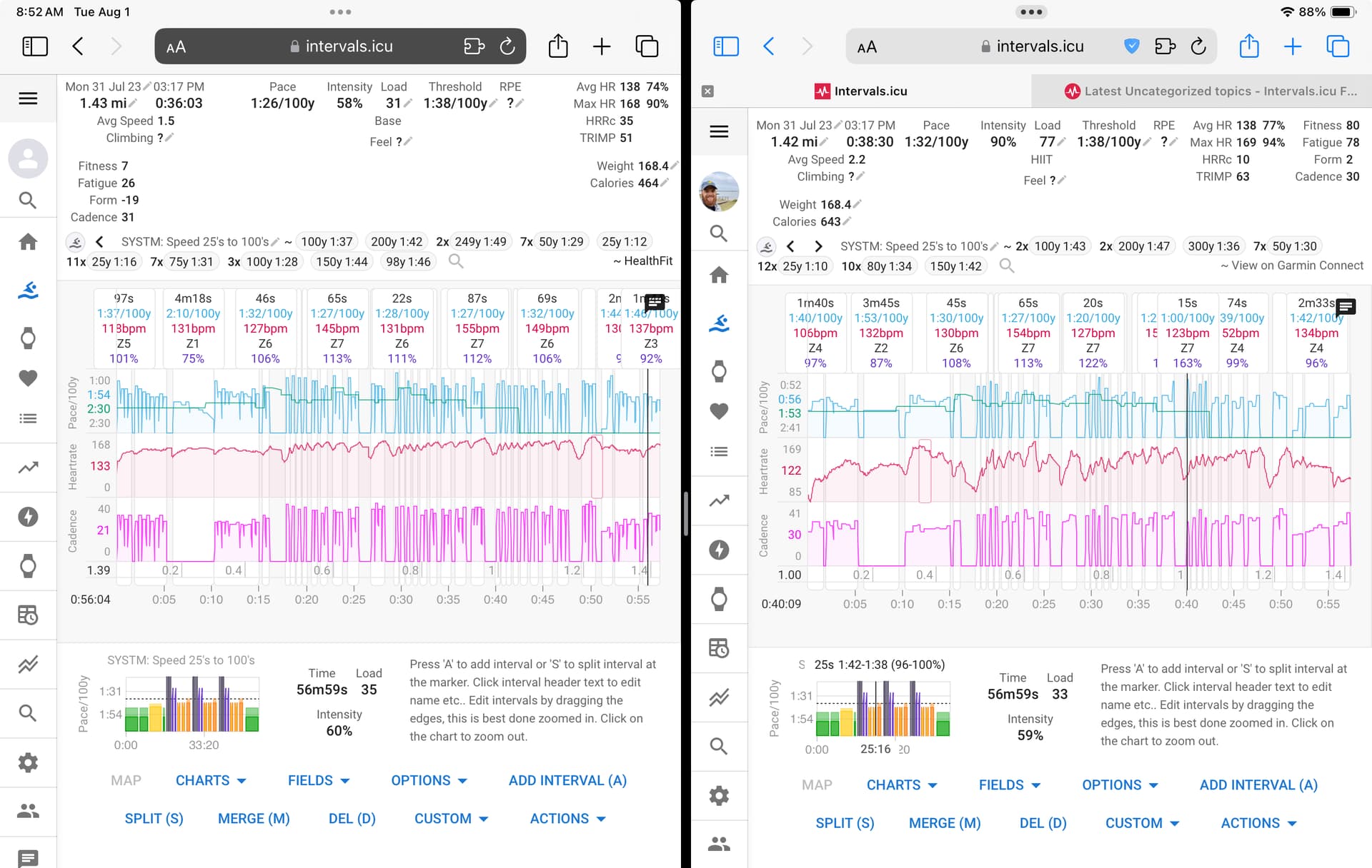

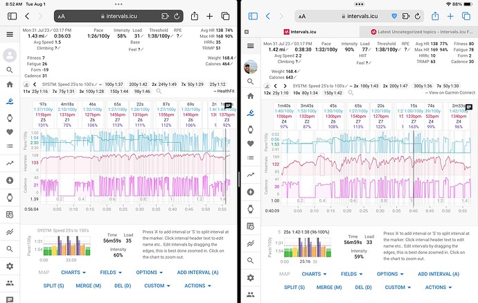

Yesterday I swam with my Apple Watch Ultra and Garmin Enduro 2. I was pleased to see that the two watches agreed very closely in terms of heart rate, pace, and interval tracking. The workout was a structured interval swim I had programmed into intervals.icu.
I created a dummy intervals.icu account for my Apple Watch and uploaded with HealthFit. My Garmin syncs to my normal intervals.icu account.

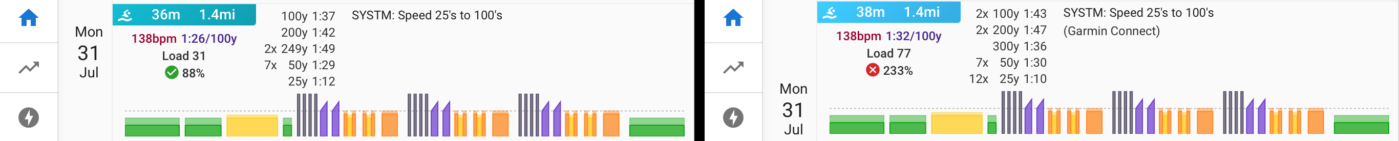

I was surprised to see that the Apple Watch registered a much lower intensity (58%) than the Garmin (90%). In terms of the measurement against the structured workout, the Apple Watch gives a green 88% and the Garmin gives a red 233%
Here are the workouts side-by-side:
I have the swim heart rate and swim pace settings set up identically between the two accounts. Any idea why one workout came in so drastically different?
Interestingly, if I delete the Garmin swim from my main account and upload the Apple swim to the same paired workout, it’s even worse: the intensity is 98% and workout compliance is 272% Uploading the Garmin swim to the temporary account gives a 60% intensity and 97% workout compliance.
What’s going on here? Clearly there’s something different about how the main account is set up vs. the virgin temp account. The swim yesterday was definitely somewhere between an 85-105% effort relative to the prescribed structured interval set. I certainly did not give a 272% effort.
