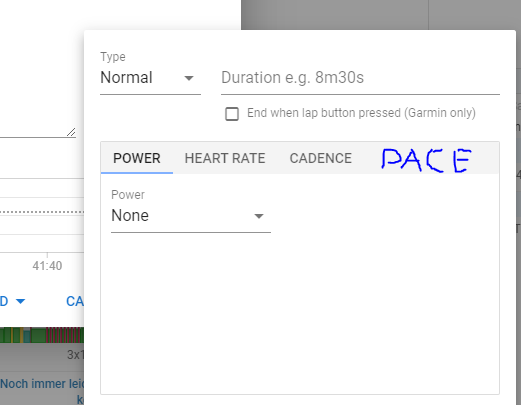

Hey David,
maybe it’s not the right topic here, but if you are working on implementing the running things - would be glad about something like that:
BR
Stefan
Tx for the info guys. @Stefan_Riegler Yes I am looking at pace zones as well.
