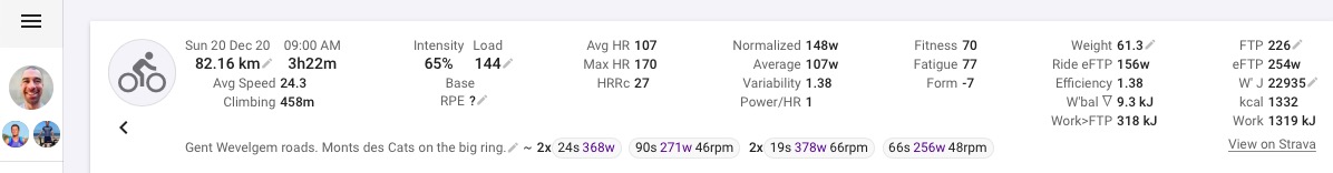

On the athlete page, when you click on the avatar in the top left corner, you get this :
Where does this FTP come from ? it’s not my eFTP and it’s not my FTP.
Is it the same for other athletes I follow ?
Thank you

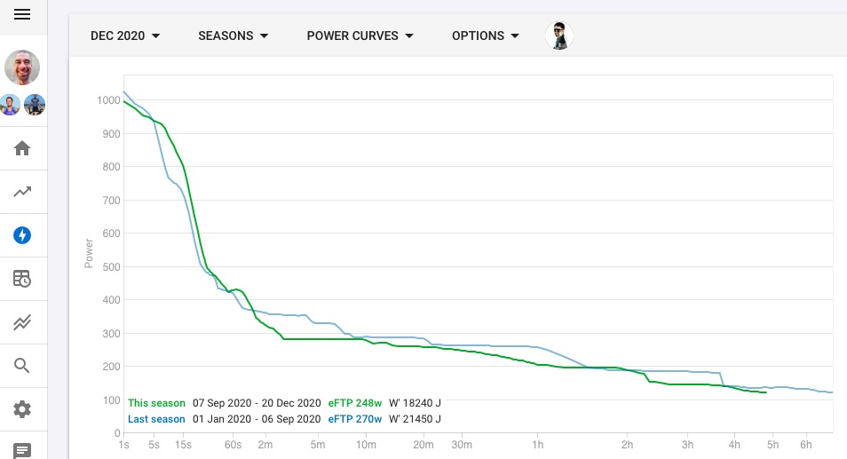

That should be your current eFTP and is working for me. I have just changed the label to “eFTP”.
ok thank you, but the eFTP for what period ?
I cherry pick here because for me it’s not the eFTP for the current season

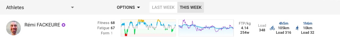

But on the activities page, the current eFTP is 254.
It is the continuously updated eFTP with decay. So probably from something you did last season. You can add a “Set eFTP” calendar entry at the start of the current season to set eFTP something lower so it picks up whatever you have done so far this season.
