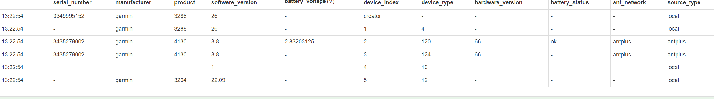

What is under the device_info header?
Only your watch, or something more?
My watch and an antplus device, presumably my cheststrap HRM. The number of rows differ between activities, but here is an example:
