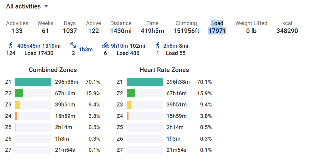

What does training load tell me . .
I’m new to the site
What does training load tell me here?
Is it good or pathetic or what?
I edited my Workouts and put pace last and it dropped to 13,327
I am fairly new as well, but this is the blurb that pops up when I click on “Load”…
“Training load is an estimate of how hard a given activity was relative to the athletes capabilities. For activities with power it depends on the intensity of the session (relative to FTP) and duration. 1 hour at 100% of FTP is 100 training load (see bikehub.co.za). Intervals.icu can also estimate training load using heart rate and gradient adjusted pace. The priority of different training loads and the models used are configurable in settings.”
So what is a load of 261 mean if it’s way over an hour? Does it mean it does not know what my FTP is or what? I have one long hike with a load of 261 and 4995 kcal. Searching YouTube it seems to apply to biking rather than running or hiking as it can be tested on a Zwift bike.

It might be helpful to mention the origin of TSS is Banister’s impulse-response model. At the workout level, TSS is attempting to represent the impulse, or dosage of training. The model predicts, assuming appropriate recovery, some change in fitness as a result (the response). That’s the science-y part of training. The artsy part is related to questions regarding the correct amount of TSS, how you build that TSS throughout the week, the training cadence/rhythm as it relates to building and recovery days, etc.
At the level in your image (a year), I tend to think of TSS as more akin to “work-done”.
Building training load over time (or the capacity to train) has worked for me, but I do wonder whether I would realize even better results by ceasing to focus so intently on building load, and instead take a more wholistic approach, i.e, trying to build load in a way that incorporates more variability in terms of TSS per day throughout the week.
