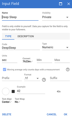

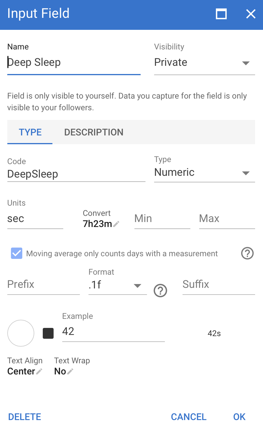

Sleep - numbers sent to Intervals.icu is in seconds. But it can be dispayed on the calendar as hh:mm:ss.. see screenshot “convert”.

I don’t have the “Apple” bridge, so I write down the data manually. Garmin is telling ms hrs:mins, and it would be annoying convert these in seconds only to be re-converted by Intervals in hrs:mins…

yeah.. it’s a display vs raw number situation.

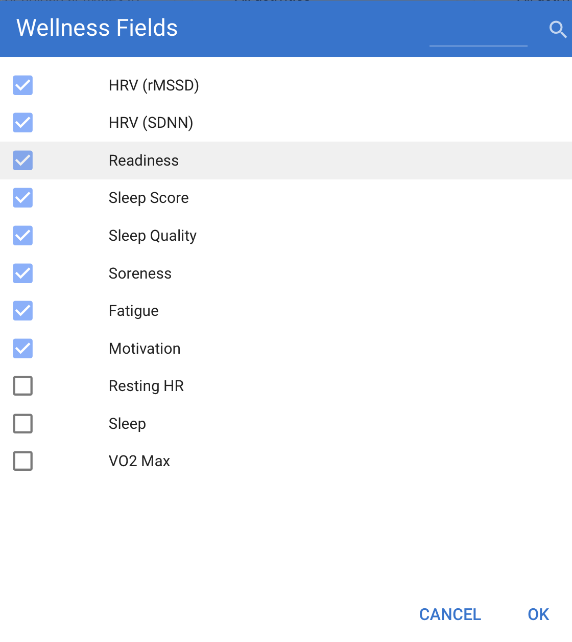

Also, looks like this is not supported (I don’t see it as a field)
