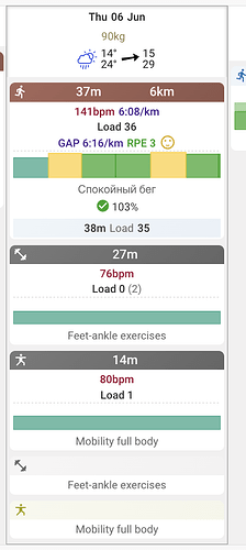

Weight and Pilates trainings do not match with actual workouts coming from Garmin

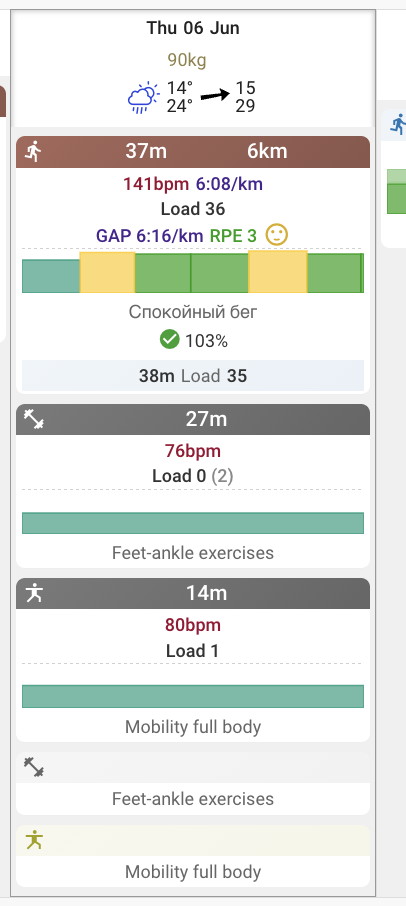

My coach creates a training plan for a week which includes weight and pilates trainings which go to Garmin OK and I can start workouts on my watch with that exact planned training. Actual workouts go back to Intervals fine, but they don’t get matched with original trainings, thus creating a duplicate record.

Show us some details about what is specified in the workouts. We may be able to give some advice.

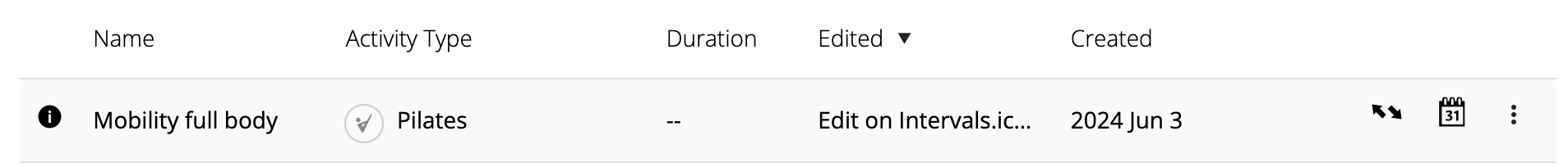

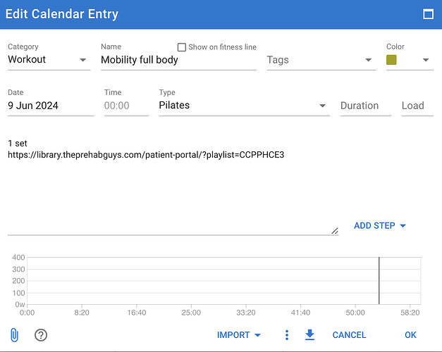

This is an original source:

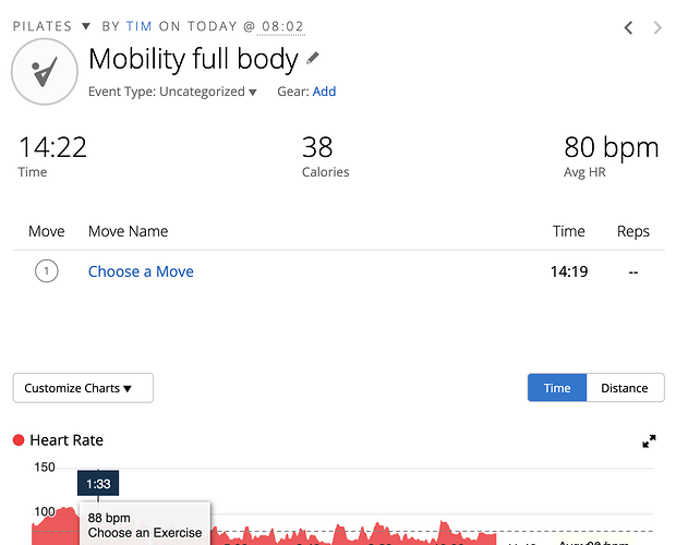

This is how it looks like in Garmin Connect:

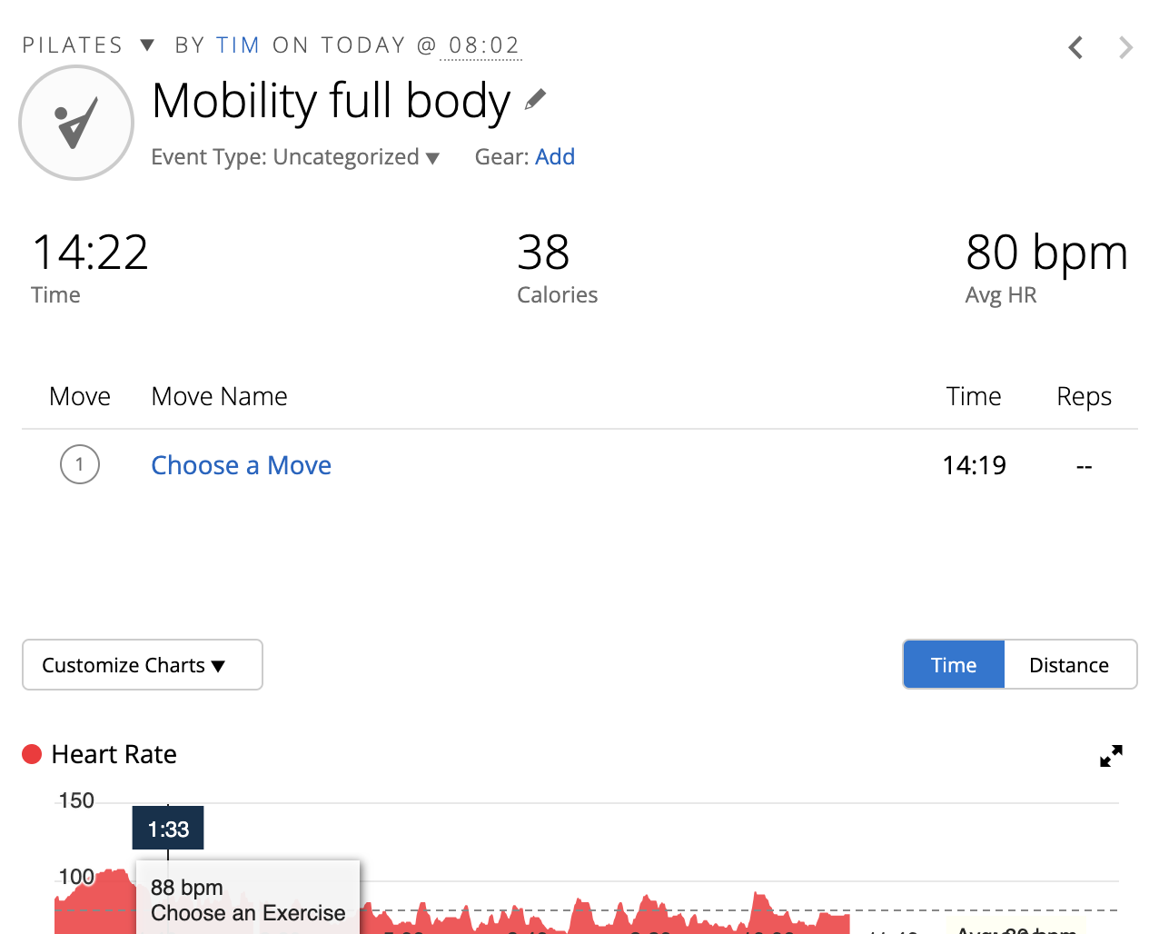

And here is an actual workout record in Garmin:

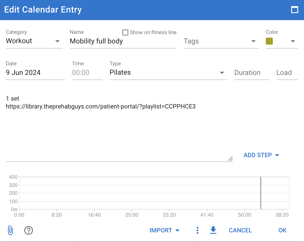

The workout doesn’t have any load or duration, so Intervals can’t pair it to the activity
Try to add an approximative duration to the workout, like 15min in this case.
