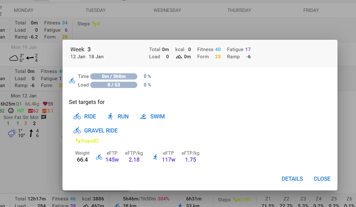

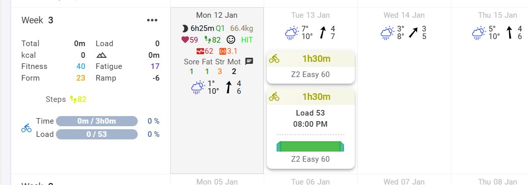

Where can i see just doe numbers of “done” and notr also of planned? also under totals i see also plannes workouts, but i need to see the number of done.
ok, and..silly question, how can i see the planned numbers? i think thats important values i always want to see…not by clicking through options…just both numbers “actual/planned”…is it a feature request?
If you want the progress bars visible all the time without any clicking, you must disable ‘Show totals on top’. Then the totals section moves to the left.
