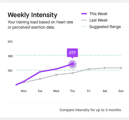

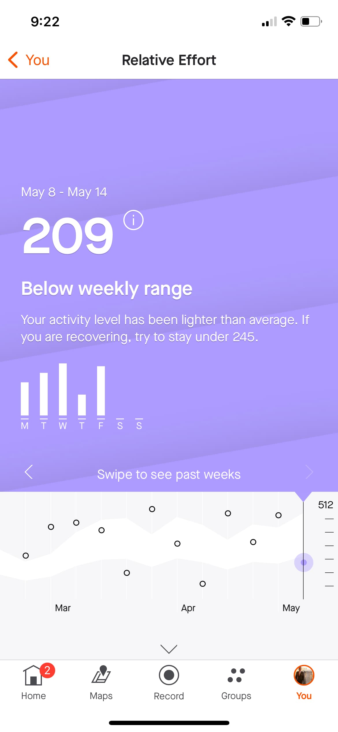

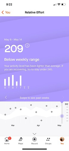

Hi all, relatively new to training and I’m really liking this tool vs the Strava premium trial I explored last month. Some guidance that I liked about Strava, however, is it would give load recommendations for the week, especially useful for a newbie like myself. I found it useful in managing my load, especially during a recovery week. Attached is an example telling me to keep my weekly load under 245 if I’m in a recovery week.
Is there a way for me to add a chart that can quickly help me figure out a load target for the week?

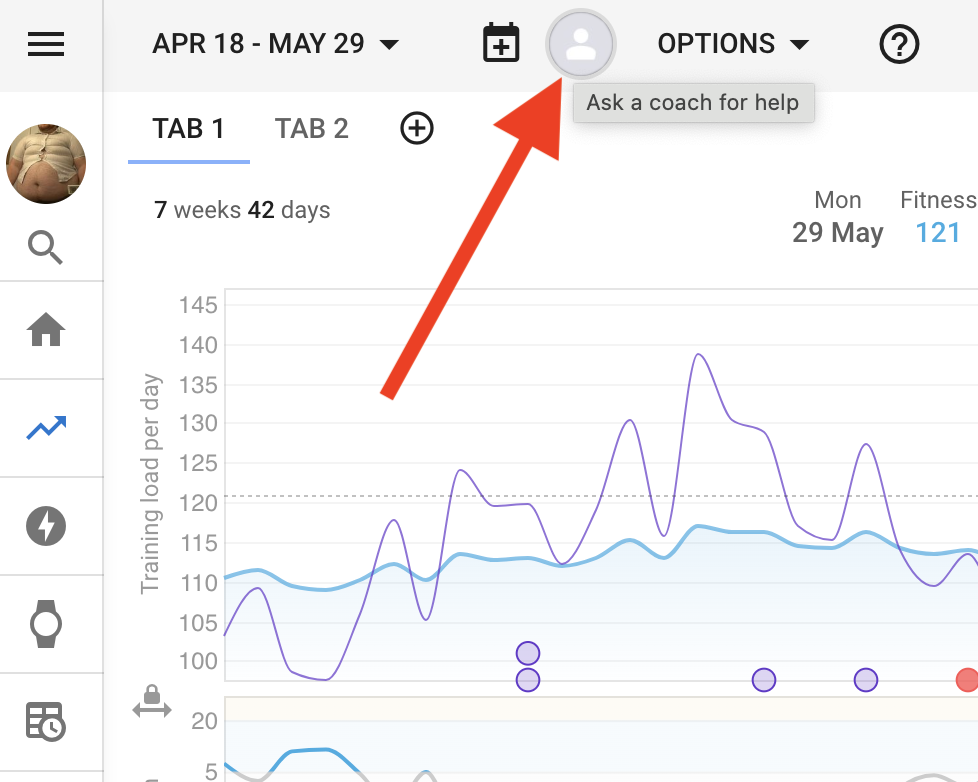

There are so many variables in figuring out what your load should be; age, free time, experience, goals, current load, current life stress, injury, etc. I’d suggest this would be best answered by a coach consult. You might try the “ask a coach” button found throughout the Intervals UI

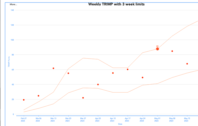

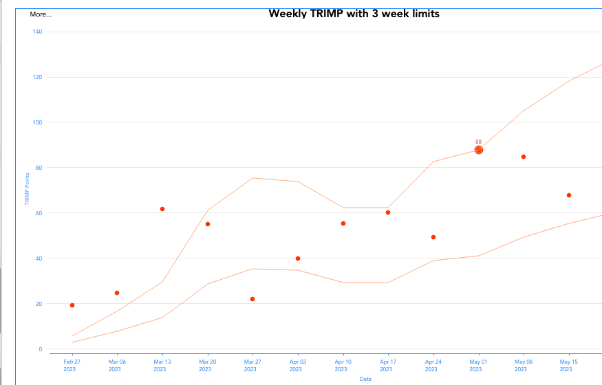

Going back to your post you show the Strava suggested training range in your screenshot. I’ve never been able to find that formula documented anywhere, but when I was using Golden Cheetah I seemed to get pretty close by using a range of 75% - 160% of the previous 3 weeks’ average training load. The shape drawn by that seemed to match the Strava graph, so I used that for a while in Golden Cheetah
These days I’m planning the weekly numbers including harder / easier weeks on a spreadsheet and then updating that into a daily plan in intervals.icu

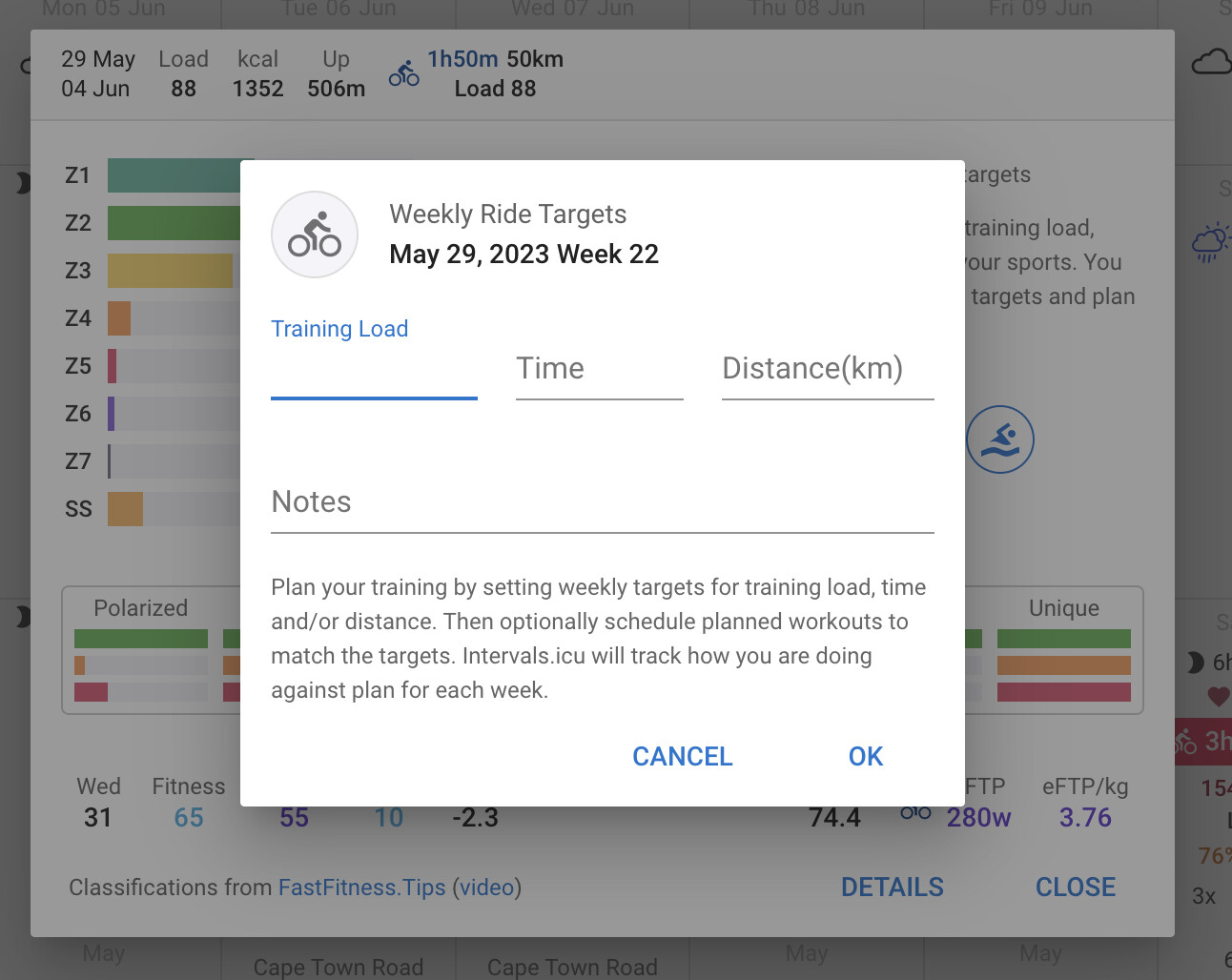

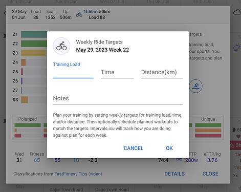

Using a spreadsheet is the most flexible but Intervals.icu does support setting weekly load targets (click the week block to get the popup):
