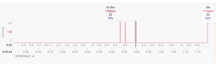

@David this walk - Intervals.icu - loads like this:

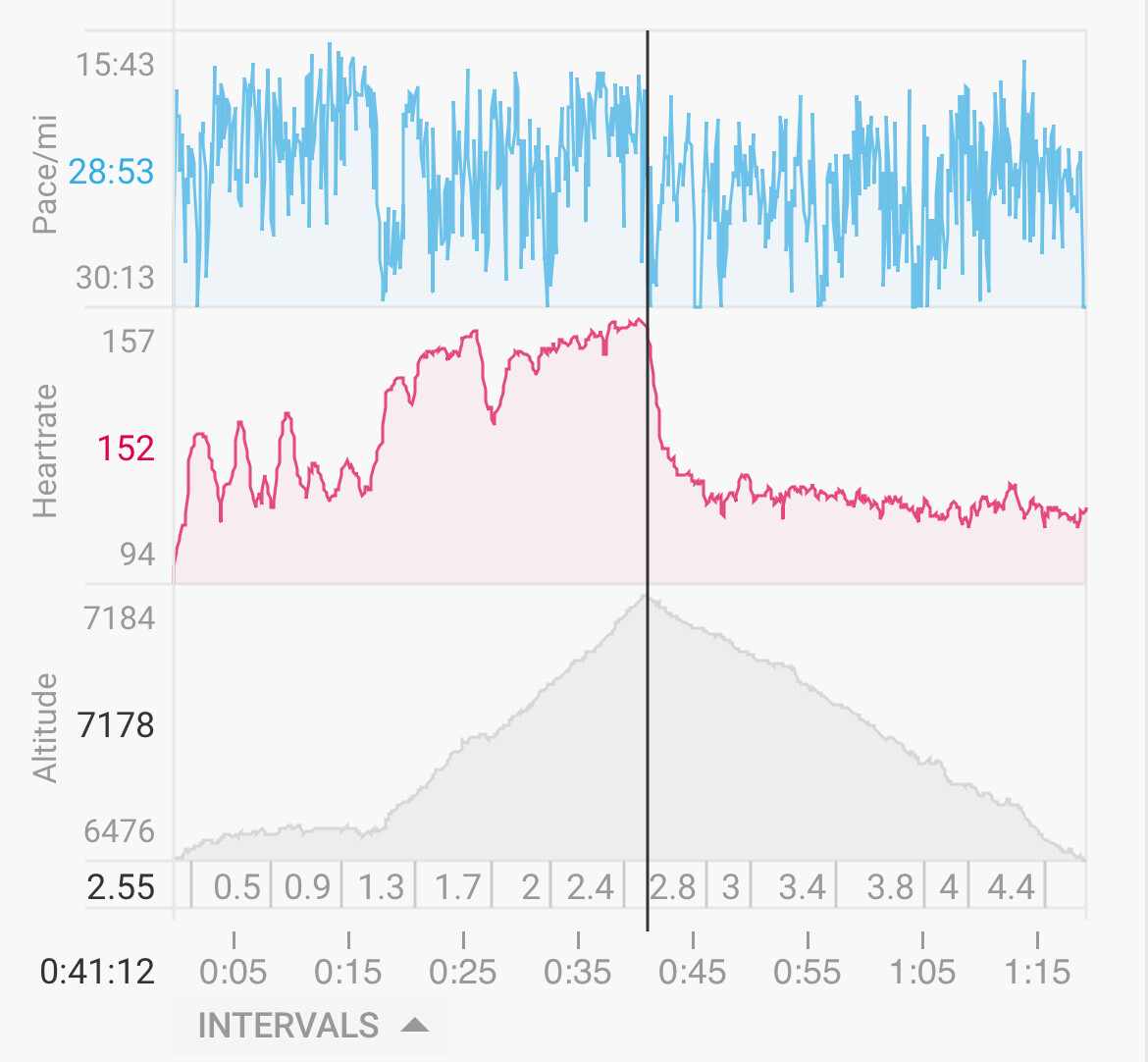

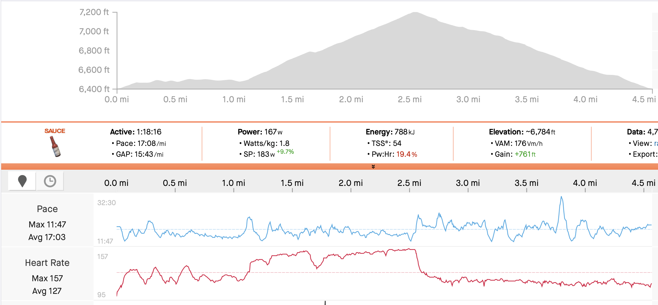

but on Strava and everywhere else looks like this:

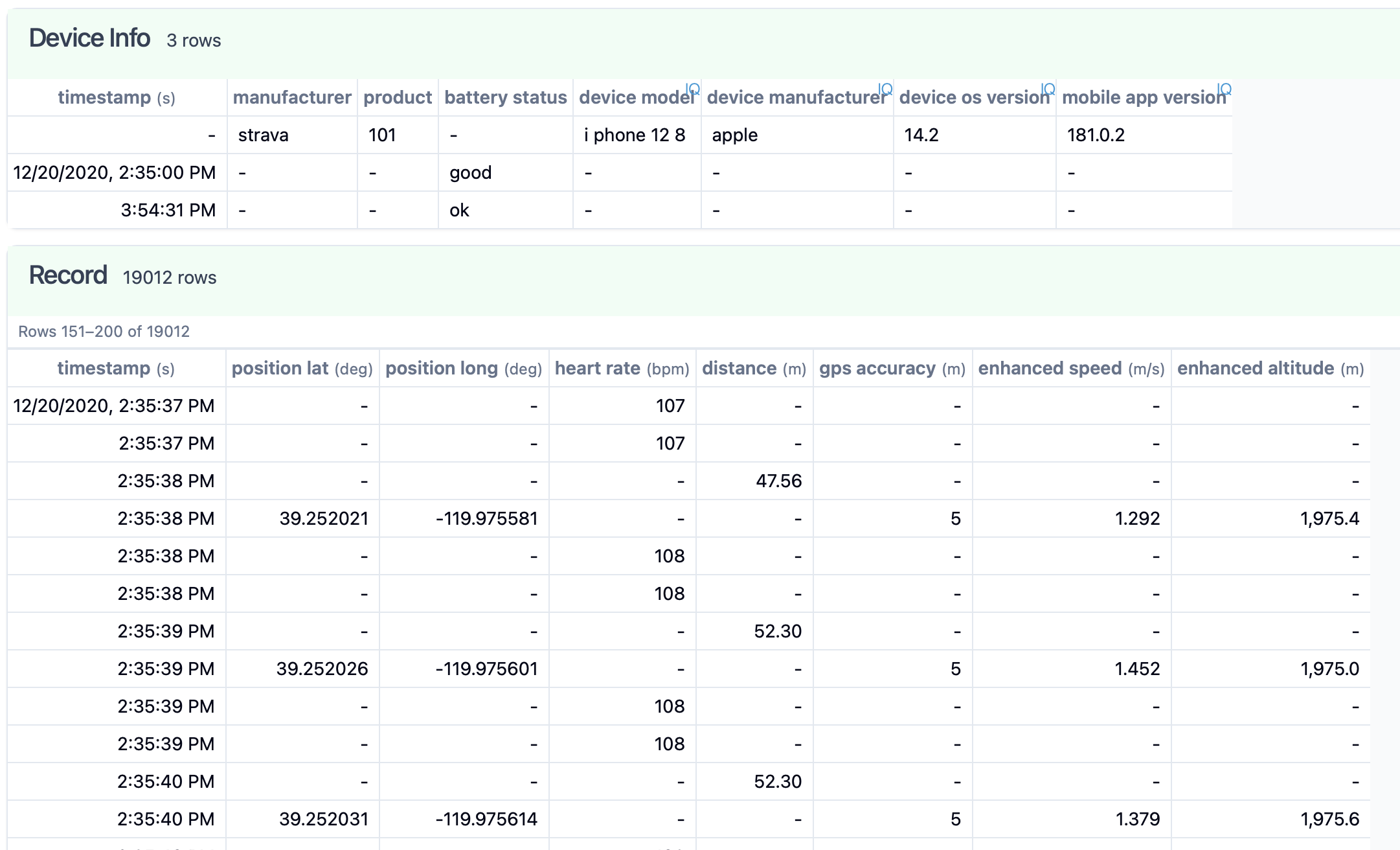

downloaded the original .fit from Strava and tossed into fitfileviewer.com and this was interesting:
oddly there are 4 Record messages for each timestamp…
I have fixed this by merging records with duplicate timestamps. If the same value exists in more than one record with the same timestamp then the first non-null, non-zero value is kept. Will deploy Sunday AM (GMT+2). Tx for the report.
