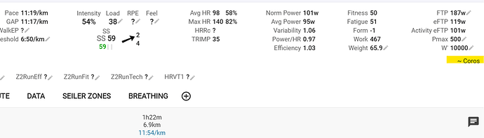

To check which file made it to Intervals, look at the bottom right of the summary section.
If you see Wahoo, the file came in. If you see Strava, it’s the Strava one. If you see both Wahoo and Strava, then both came in and Intervals will use the data from Wahoo with some extra functionality from Strava (naming for example).
Situation one and three, should be good. Situation two, depends on what Strava sent through.

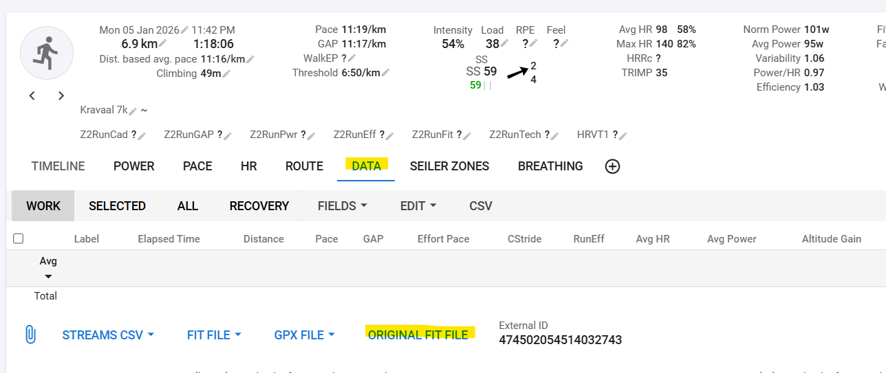

The FIT file that made it to Intervals can be downloaded from the Data Tab. Inspect that one with fitfileviewer to see if it has power values and in which field.
Don’t look for a field called ‘dev’. A dev field can be called anything and is named as the developer decided. Power2, trainer_power, secundary_power,… are examples which are known of being used.
