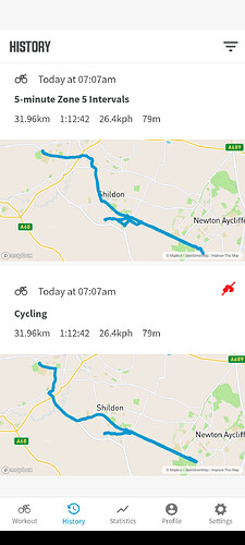

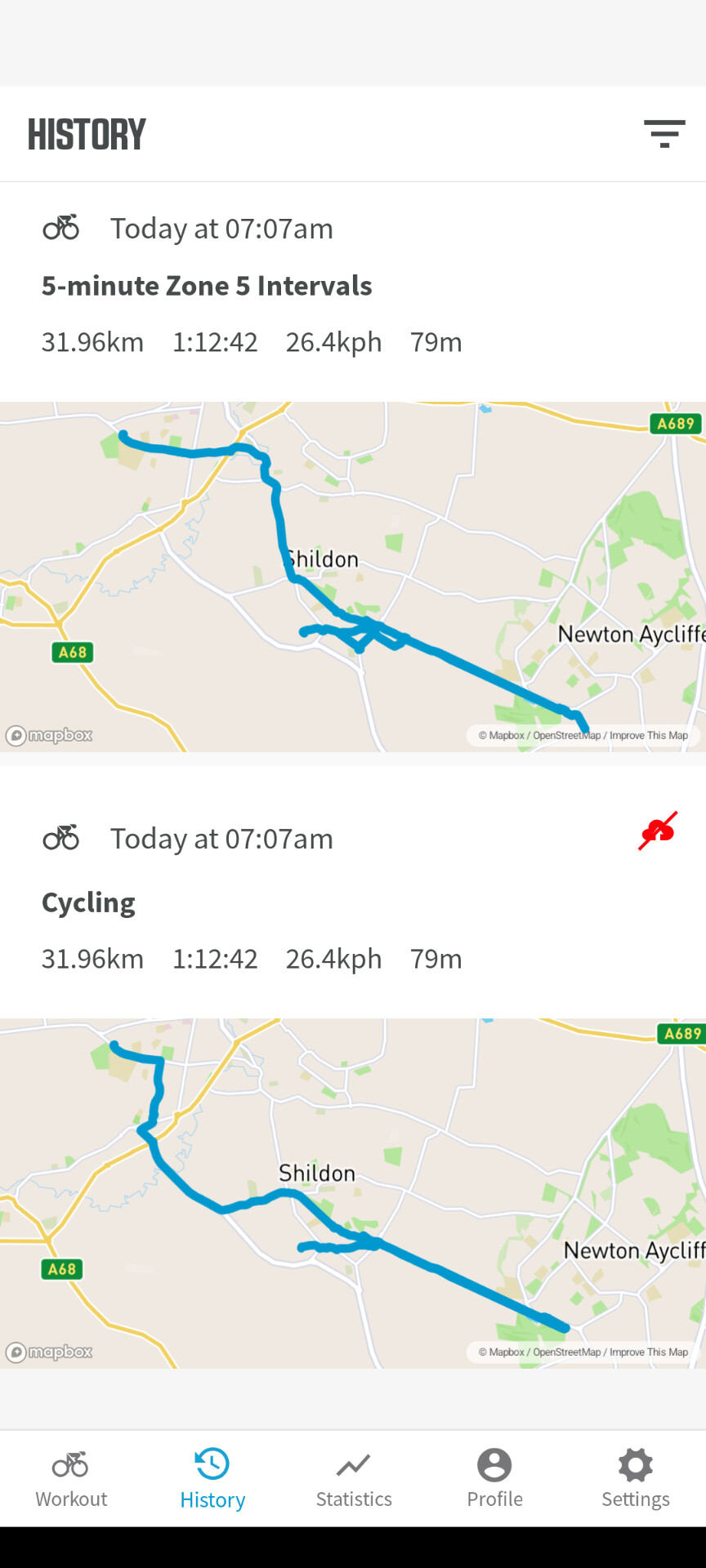

I’m repeating a training program I did a few weeks ago and this morning I noticed that the session appeared as synced in Wahoo’s cloud (no workout name for the activity), but wasn’t in Intervals. I refreshed the Wahoo app and the same session appeared that I had done 4 weeks ago at the top of the list, with today’s session showing as not uploaded anymore.
Are you seeing the same issue?
The bottom activity is today, top one some weeks ago:

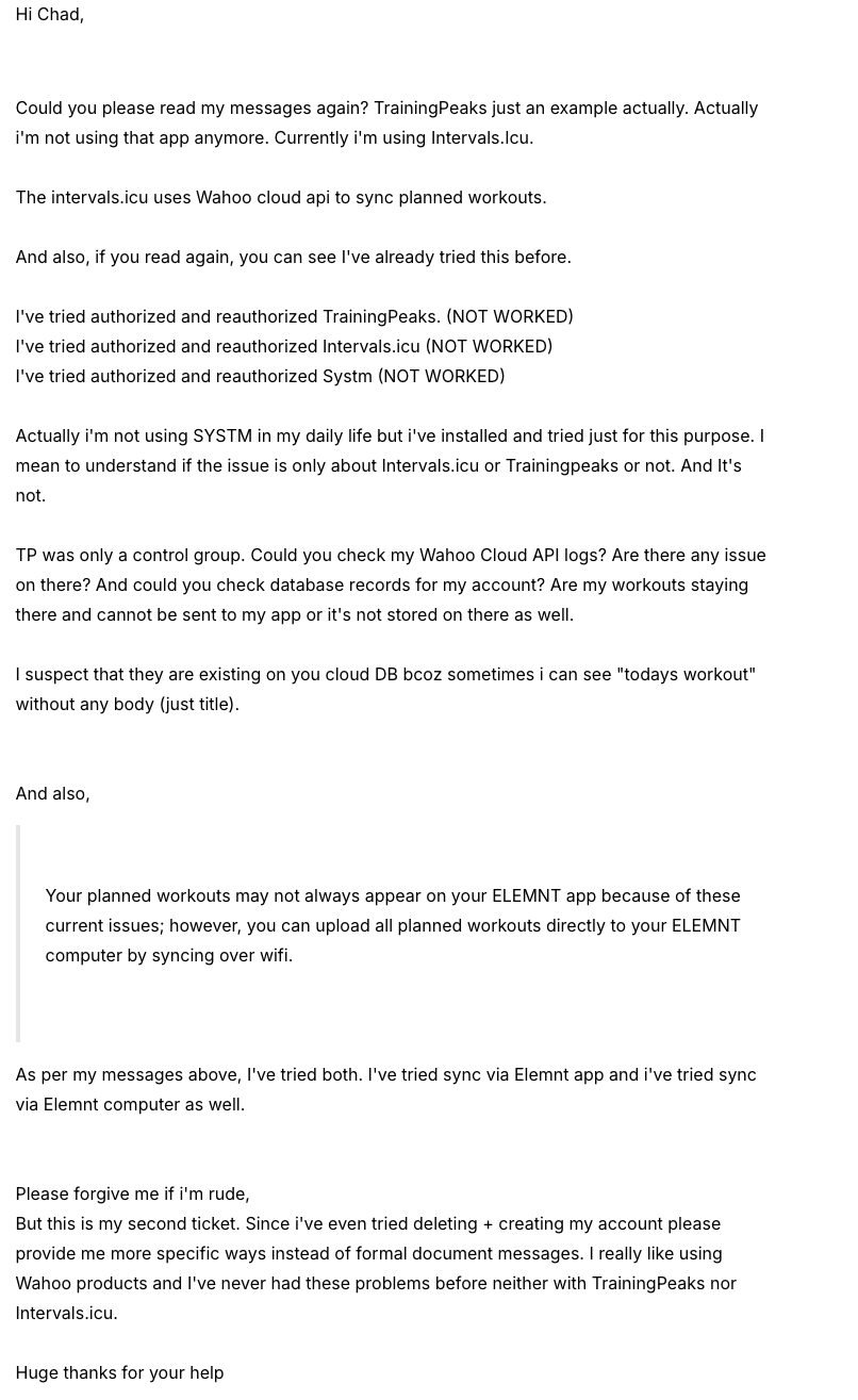

Things that Wahoo support asked me to do that haven’t worked:
• Deauthorize intervals.icu
• Uninstall ELEMNT app
• Factory reset computer
• Authorize intervals ICU through wahooligan.com
• Reinstall ELEMNT app
• Pair computer and test

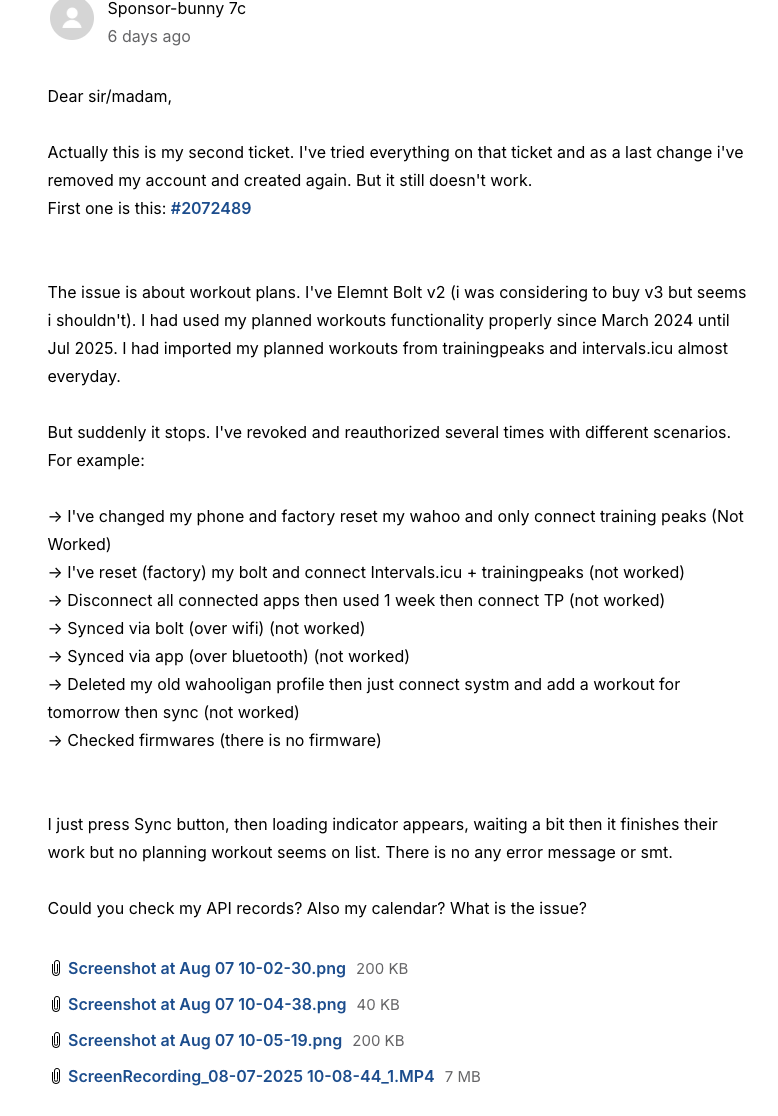

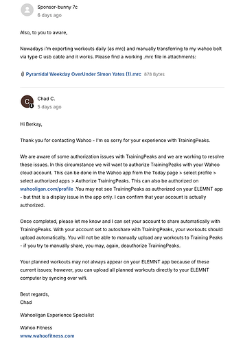

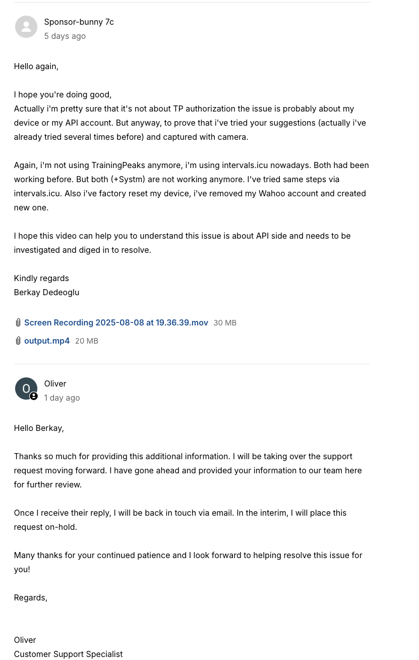

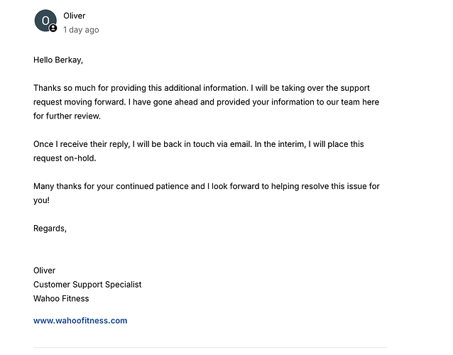

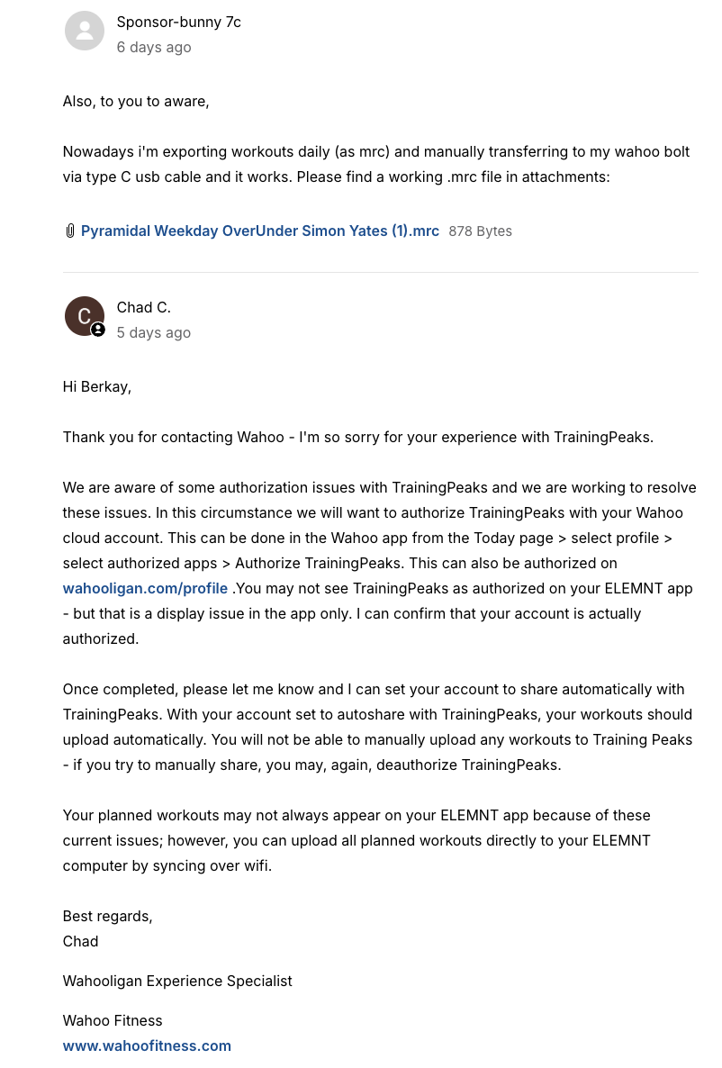

Ah yes me too btw. Let me share the whole communication between Wahoo Support and me. Maybe someone want to reach them also.
That’s great, I’ve referred my Wahoo support agent to this thread, hopefully they can work something out.

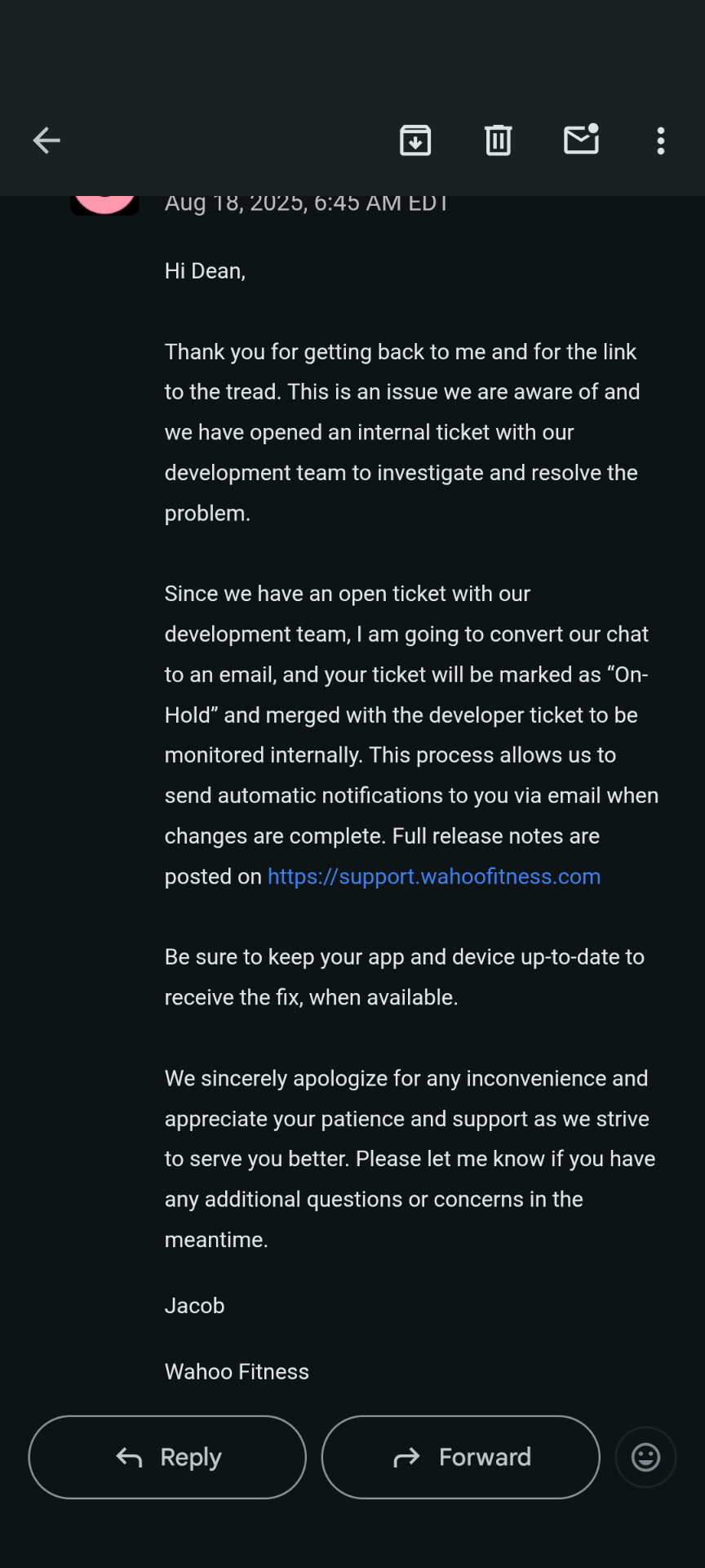

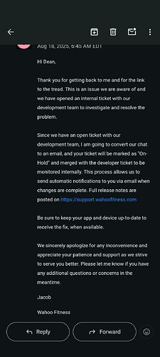

@BerkayDedeoglu I finally got a response from Wahoo after the obligatory few days wait. It is basically what you received but hopefully we’ll see a resolution soon.
