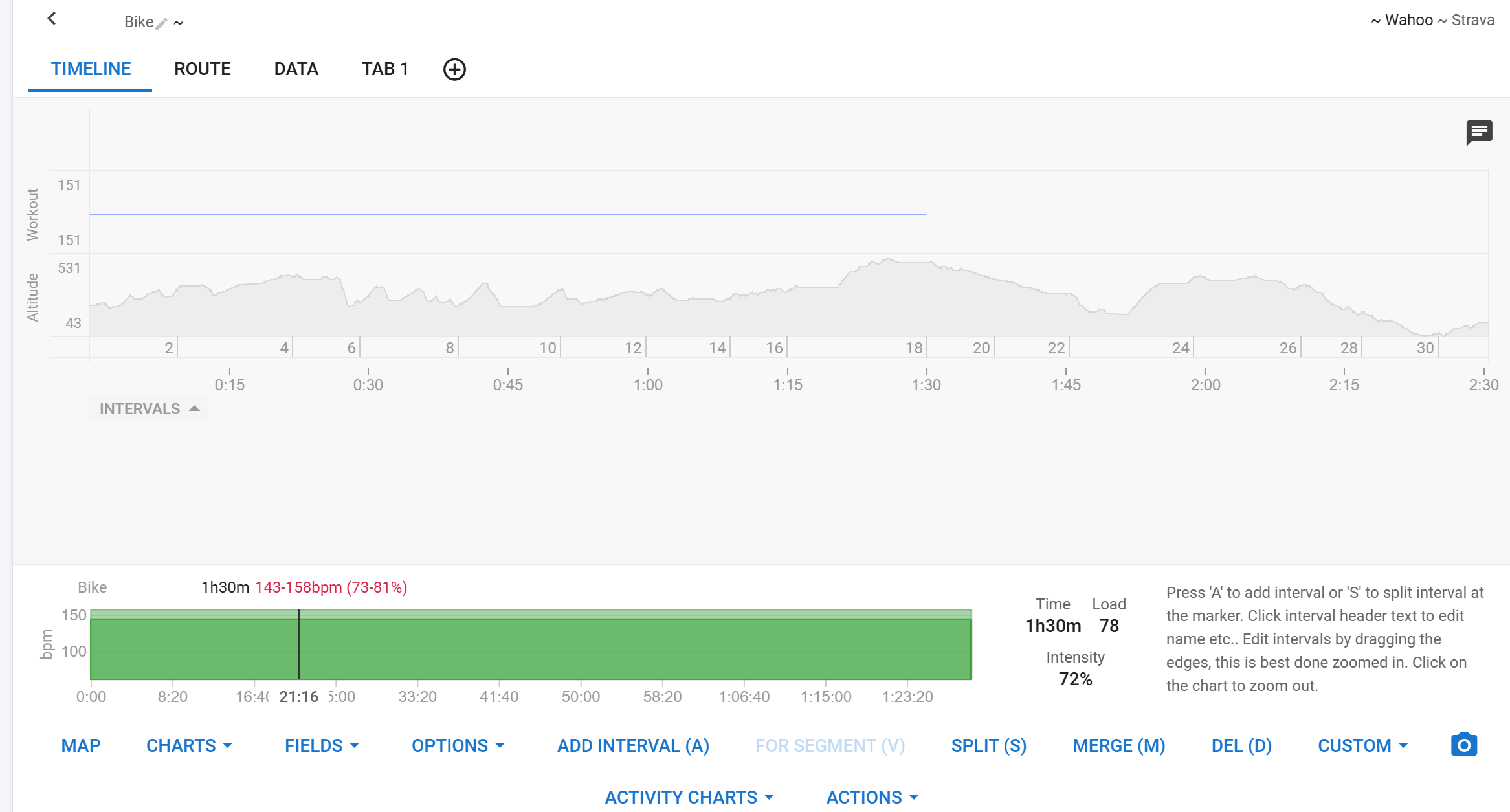

I recently connected my account to Wahoo and Strava, and it seems that intervals is pulling the exercises, as it captures time and altitude from the Wahoo, but it lacks information, specifically speed, over the course of my rides.
Every other activity (Peloton, Garmin) upload their metrics properly, just the wahoo that has been an issue.
Below is one example of a recent ride (waiting for a sync for > 1w does not change anything).
Is this an issue of not being able to pull from Strava, and that taking precedent over Wahoo?

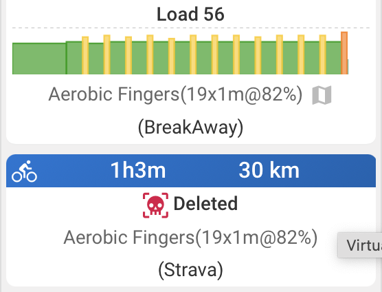

Wahoo will take precedent and you shld see a “DELETED” (if you do options → show deleted) for Strava data.
eg:
Thanks for the response! I do see the deleted entries. I was expecting to have speed, not just altitude from my Elment Bolt. Is this not the case?
Is this an outdoor activity or on smarttrainer?
It’s an outdoor activity. I also have Garmin data for heart rate, but that is reported well.
Download the Wahoo FIT file and check which streams are in there with fitfiletools.com.
