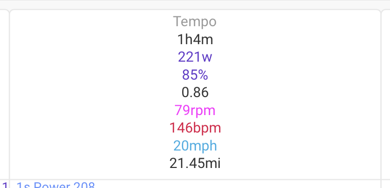

My 840 will give LTHR estimates of say 159bpm, and I go out and do ~1 hour tempo:
at 85% my-est-FTP, with a HR in mid 140s (average of 146bpm).
And the 840 will estimate my FTP at something like 218-222W (can’t remember exact number). Despite knowing my LTHR is close to 160bpm, and that effort was roughly 91% LTHR.
Its like the 530 understood power-to-LTHR, and the 840 does not.
