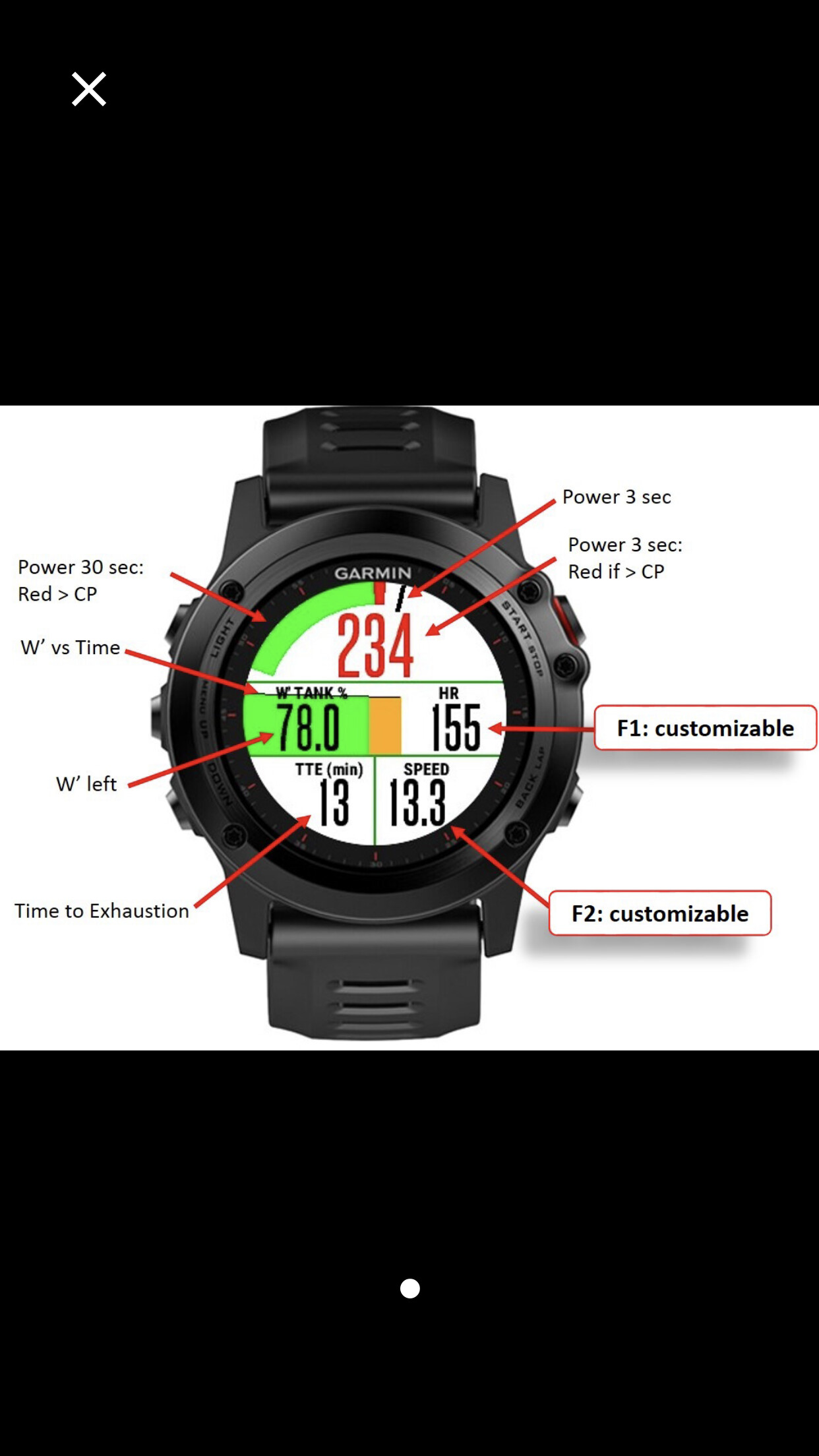

Mean while if have Garmin compatible with connect IQ I recommend the CPSience data field.
Xert does that, and they have a Garmin IQ whatever app
Take a look at Training Power if you have a Garmin Edge.
