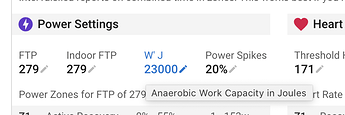

You need to capture your W’ in /settings:
This is copied onto each activity:
Then the W’bal chart should show up. You can get a W’ estimate on the /power page.
