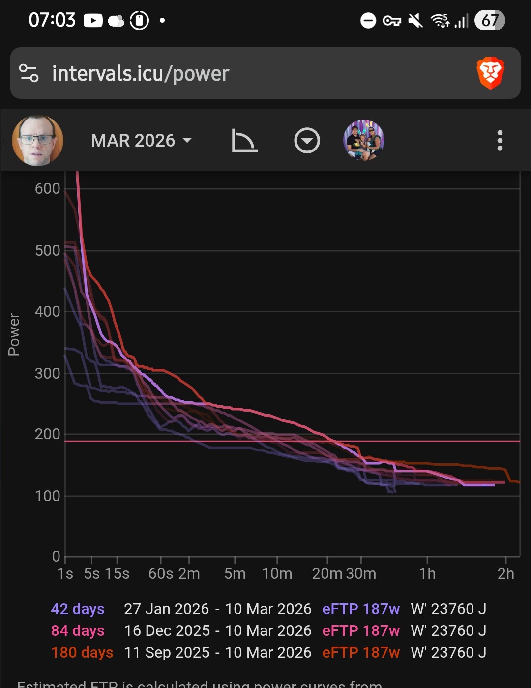

You can get it from Intervals.icu now on the /power page. The W’ value displayed for a given curve is calculated from the data for that curve and not just based on a standard value for the eFTP. The circle on the power curve further to the left is the point used to calculate W’.

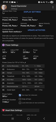

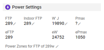

On my power page I have a current W’ number of 19890J
On my settings page I have plugged in the 19890J but then I see there’s also an estimated watt prime eW’ of 24752
I understood the 19890J W’ number on the power page was the estimated W’ no? So what does the eW’ number represent?
I do note on rides my W’bal will go negative. Is the eW’ essentially an estimated update to the figure given on the power page informed by recent activity data? If not, then what is the eW’ number and what data is generating it?
Mine is the opposite to yours where my W’ on the Power tab is higher than the eW’ which seems incongruous. Perhaps @david or @MedTechCD might be able to explain the difference as i lime you am confused.
Based on your data, it is matched to a modelled power curve. The curve used for you is based on your own data. You can be above or below the curve, indicating you have either done maximal efforts better than the modelled curve, or haven’t done efforts hard enough across the duration (x-axis). As W’ is power above CP, it’s anaerobic, so you could have a better anaerobic contribution to your power curve than the longer aerobic side (below CP).

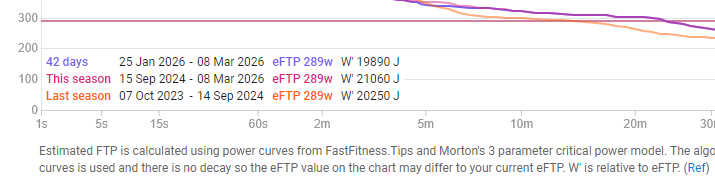

Here’s a clean look at the actual power curve above and below the model curve.
If we wanted to have W’ bal live on our head unit, which number would serve us better, W’ or eW’?
