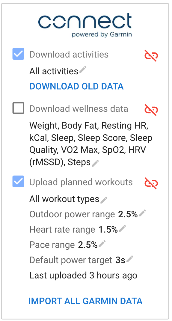

Intervals.icu will pick that up from Garmin if you are measuring it that way. Look in the Garmin box in /settings.

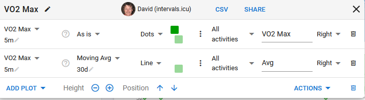

This number is great, except that it seems as though I cannot plot it over time like the eFTP?
I would also like to see my “estimated VO2 max” over time in a graph.
+1! i would like this as well!
Like this?
Yes! :D. How did you do that?

It’s a custom chart in the fitness tab. Let me know if you don’t find it.

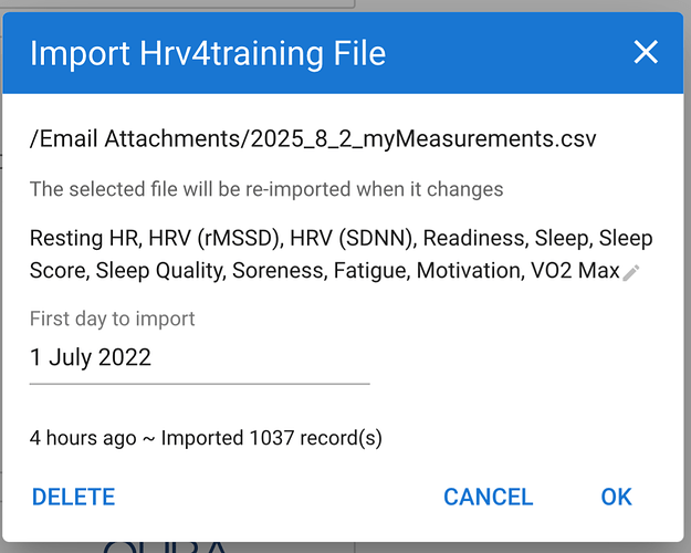

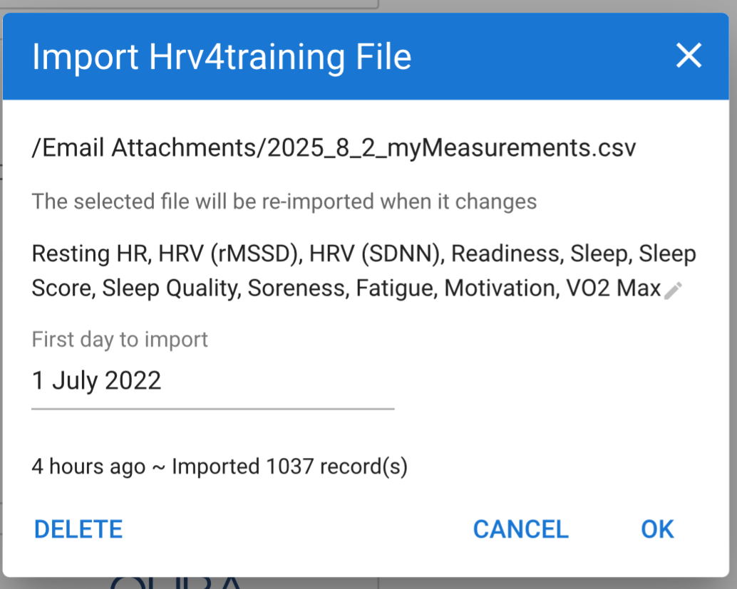

How do I get Vo2 Max data to import?
In Settings, depending on your devices used:
Garmin
Other - HRV4Training
