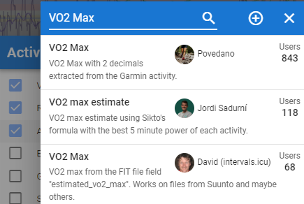

There is a custom field that will pull the value from all activities (with 2 decimal places) that you can add to your activity view. It won’t be displayed on the calendar view, but can be on the list.
From an activity, press the ‘Custom’ button, hit the magnifying glass, search for VO2 Max, and select the one by Povedano or David to add it to your activities. Recalculate the activities you want it from.
When I search for “VO2 Max”, nothing is found as “activities field”.
