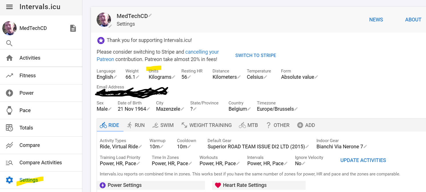

First check if you have the units correctly set on the Settings page.

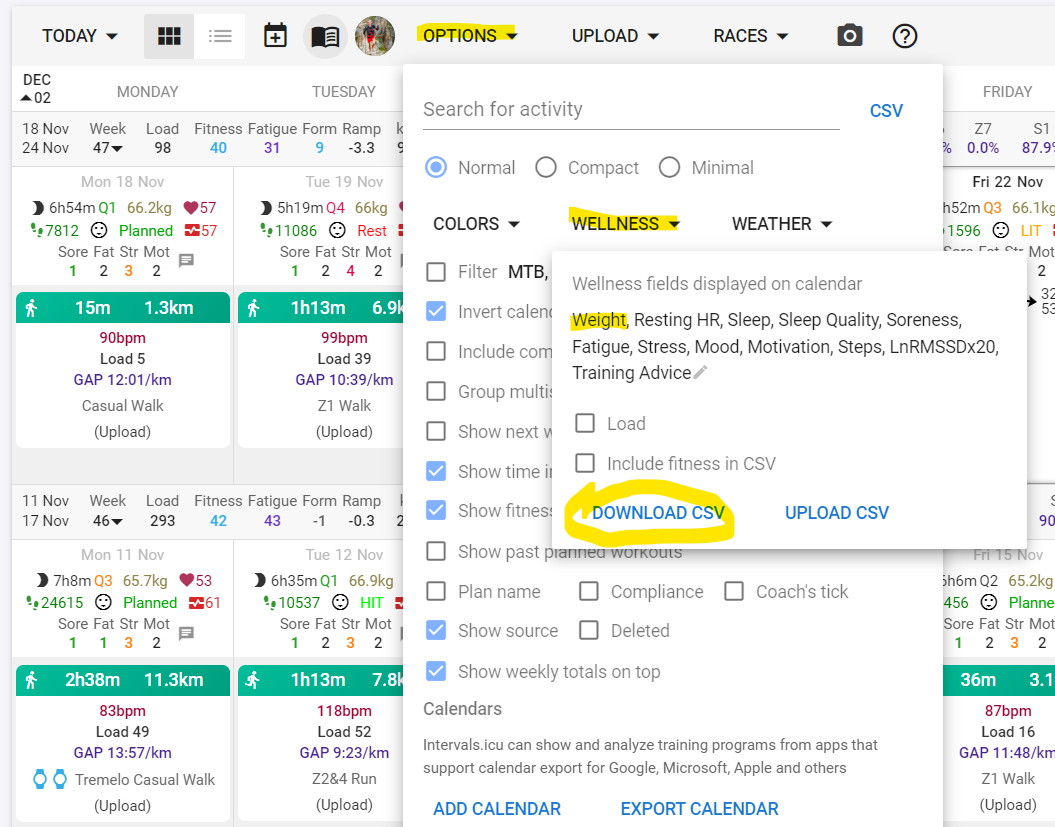

Then go here:
to download a csv of the wellness data. Open the csv and correct the wrong values, but be aware that these are and must be in KG! The conversion to Imperial happens only on the GUI.
Once corrected, re-upload from the same dialog.

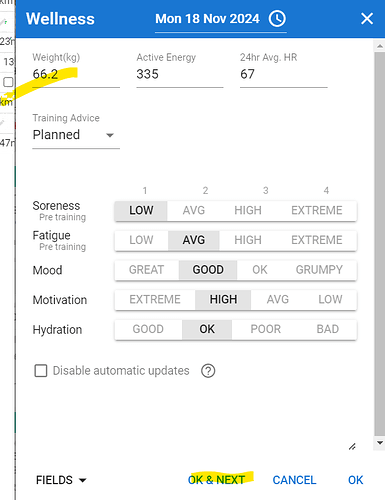

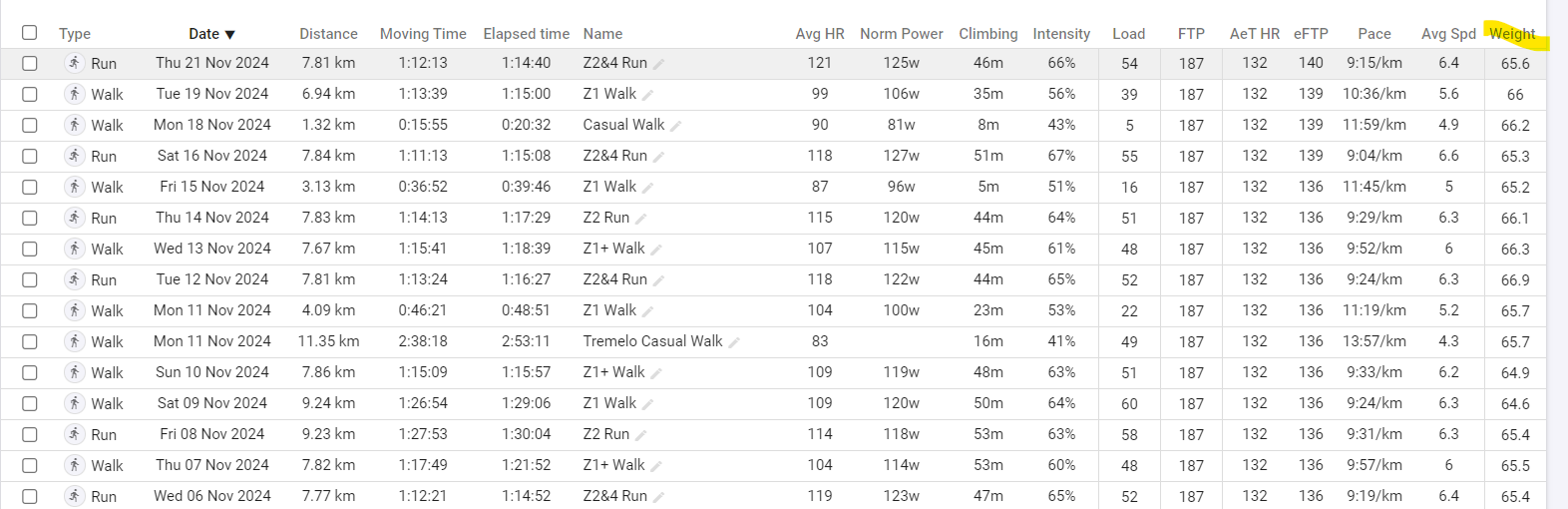

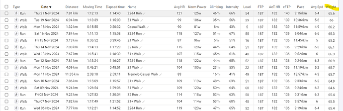

An alternative is to open the Activity List View and display the Weight column. You can click and correct Weight there, but if a wrong value remains on a date without activity, it will not be visible.

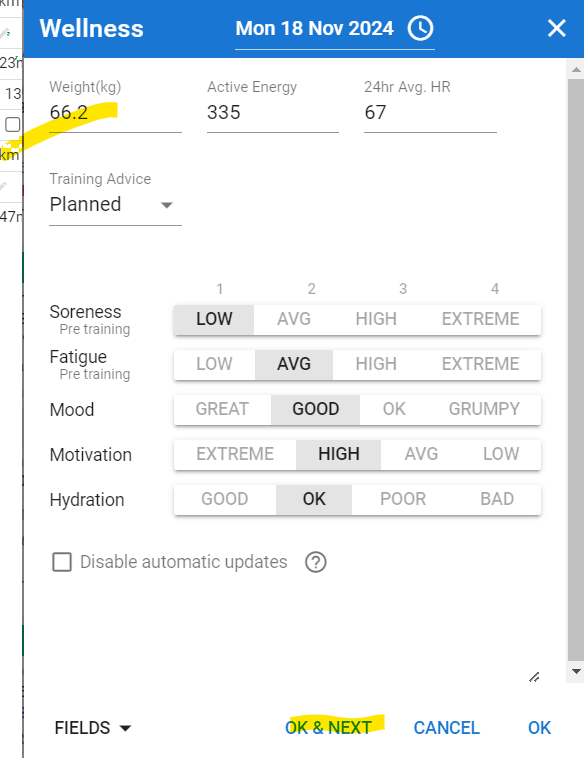

If you have only limited history, use the wellness dialog from the first date and work your way through by correcting and clicking OK & Next.
