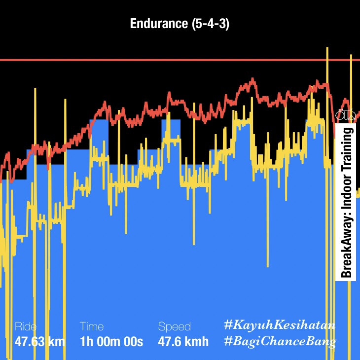

oops… you caught me there… This is a ride on my BreakAway Trainer App, whereby i tweaked the aero profile (cda) to be super duper more aero than superman. (i was the ride was like 80-100w, nursing a not so great achilles / hamstring soreness and yet still wanted to try to complete the Strava / Rapha Festive 500 - which in the end, I ended up w/ only completing 244/500km :-1: )
Actually trying to figure out how to put intervals.icu’s logo into this “auto screenshot” when the user is using an “Intervals.icu WOD”
This is the mathematical physics model used within the app to do the Power to Speed equation
