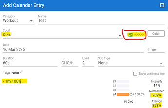

When “Ride” is selected, there is a tick box for “indoor”. When ticked, the indoor setting is used.

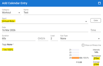

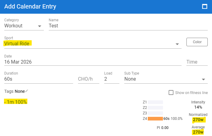

When “Virtual ride” is selected it uses the outdoor setting; there is no tick box for indoor.
