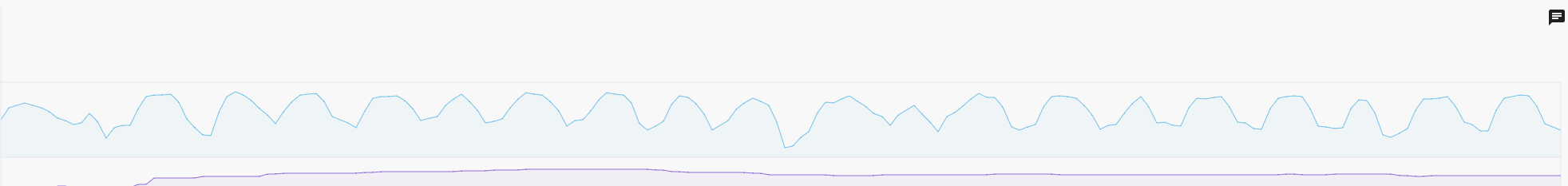

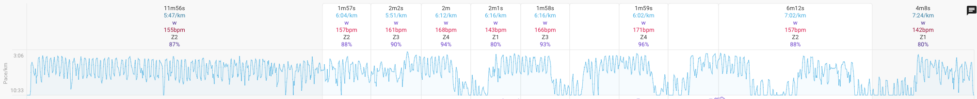

I switched to using Workoutdoors (Apple Watch app) to log my trainings. Since I have been using that, the pace in intervals has like a very high noise on it:
1 minute zoomed in:

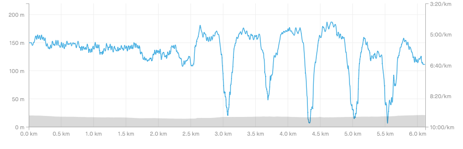

the weird thing is that I don’t have this effect in the workoutdoors app, or even in strava:
so it looks like it goes wrong somewhere in the import from strava. Any clue?
i just looked at my strava. Seems like Strava is not showing every second data. Perhaps this is smoothing things out?
I don’t think it is related to smoothing, Strave does show every 2-3 seconds and is relatively constant. The noise shown on intervals seems to be a periodic wave of ~10 seconds

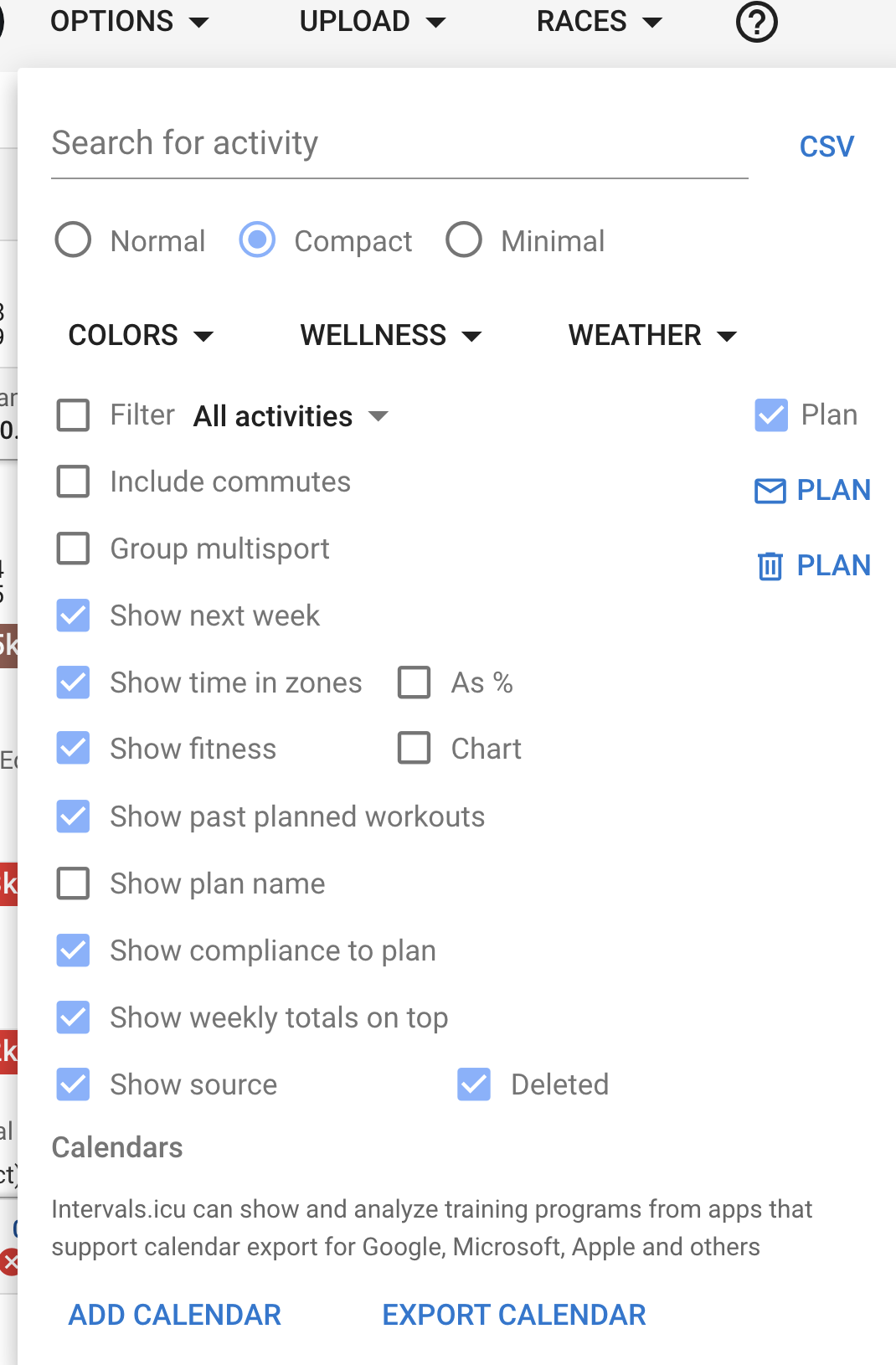

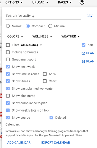

can you check “show DELETED” workouts. seems kinda strange Strava is not sending / intervals is not pulling the new workout data. It usually happens quickly.
