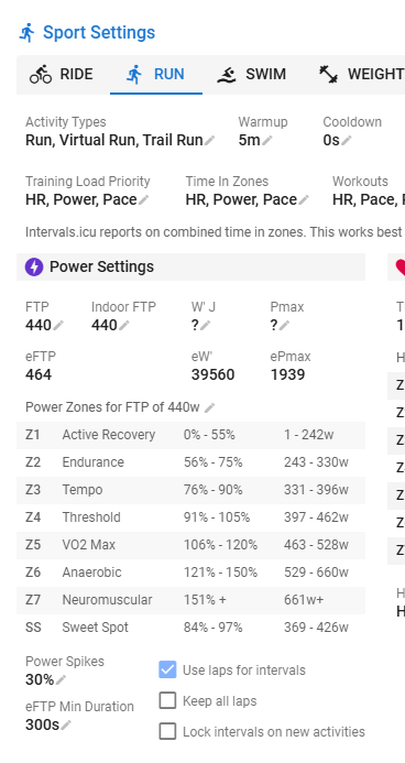

Hi, I have a problem with runs that doesnt have any laps. I have no auto-laps on my garmin or anything like that, so i have to press the lap button to create a lap. Alternatively if i do a workout, laps are created. The problem is that my uploaded runs still get intervals eventhough i have settings like “use laps for intervals” and “keep all laps” unticked. Now i have to manually do “clear intervals” on all activites without laps. Is this a bug?

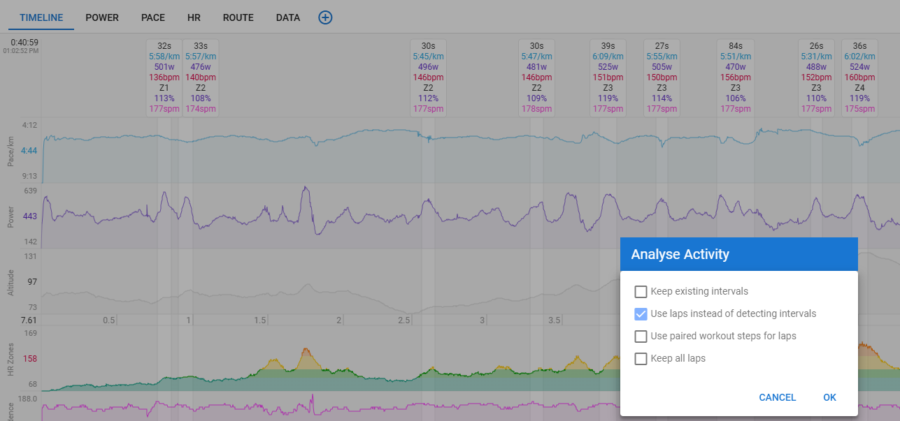

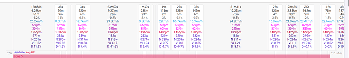

Thanks for your reply. My assumption was the same as yours; if no laps = either one big interval or none at all. But as you can see on the screenshot, intervals.icu creates intervals automaticly eventhough i have only selected “Use laps instead of detecting intervals”. I have re-analyzed the file several times with the same outcome. I have a garmin forerunner 965 if that helps.

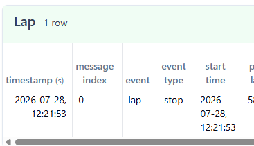

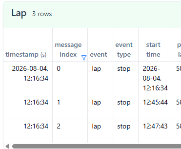

I opened 2 different .fit files in fitfileviewer to see how the laps was recorded.
In the file with no manual laps added it looked like this:
In the file where i manually added 2 lap presses it looked like this:
As you can see in the column “start time”, the first row always includes a date before the timestamp. Could it be that the code that reads and calculates intervals cant read the first line because of the different format? That could explain why no laps can be detected if there is only one line. But its just a guess. Maybe @david can confirm/reject this theory?

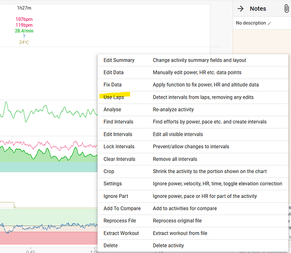

I think I discovered something that could lead to an explanation:
  • If you re-analyze with Use Laps only, no lap is detected
  • If you re-analyze with Use Laps and Keep all Laps, one big lap is detected
  • If you simply click Use Laps directly from the Actions menu, you also get one big lap
Seems like when Intervals detects no minimal effort, the entire activity is treated as a recovery interval (basically no interval). That’s the logic for the auto-detected intervals, you either only keep the effort intervals or you keep all of them.
In the case of using Laps, this should not be the case! Every lap event should start a new interval.
Like i have explained before, non of the above alternatives solves this problem. I get auto-detected laps eventhough the correct settings are applied (and re-analyze doesnt affect this either)
And to be clear; this only happens when no manual laps are added for a run. If i press lap button at least 1 time, it works like intended.
Yes, doesnt help.

I’m no longer talking alternatives. I think I may be up to the root of this issue.

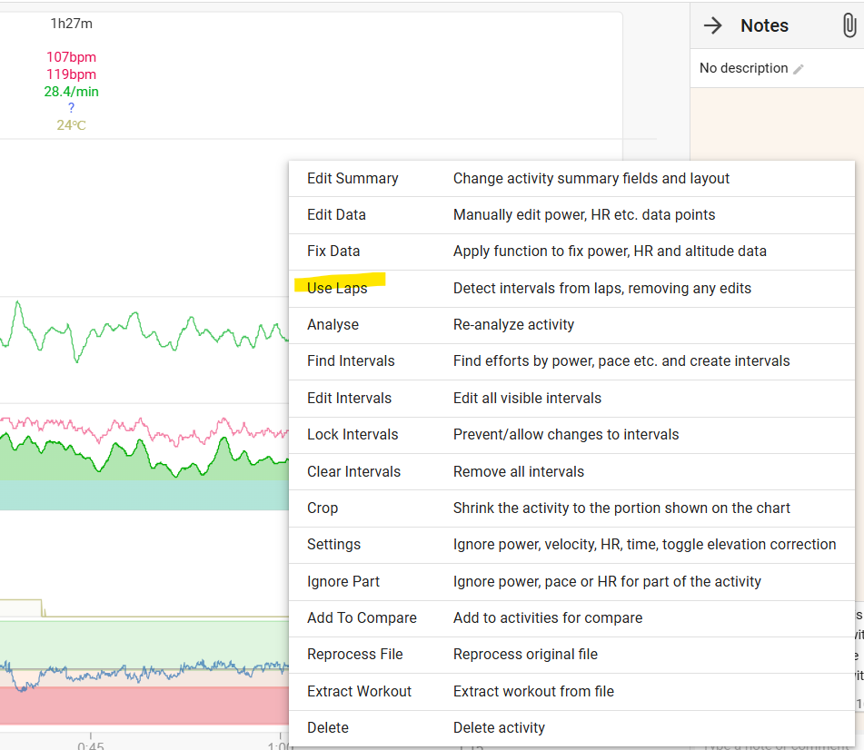

What I’m asking is to try the Use Laps from the Actions menu directly. Not a change in the settings or re-analyze or anything else. Just the command from the screenshot in my former post.
This, in my testing now, is NOT acting the same way as the Setting for Use Laps or the settings when re-analyzing.
I have tried that as well, doesnt work. Do you want the .FIT file?

Well, I can only confirm what you said. No matter what options on import or re-analysing with or without whatever option, this activity always gets auto-detected intervals…
Very strange and I can’t see why.

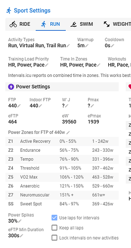

I’m seeing exactly the problem described above. Runs where I never press the lap button always get auto-detected intervals, even though the settings are:
  • Sport Settings → Run: “Use laps for intervals” checked
  • “Keep all laps” checked
What I’ve tried, without any effect:
  • Actions → Analyse with “Use laps instead of detecting intervals” (with and without “Keep all laps”)
  • Actions → Use Laps
  • Re-analysing after changing the settings
