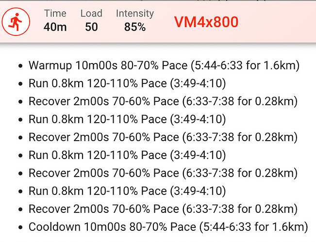

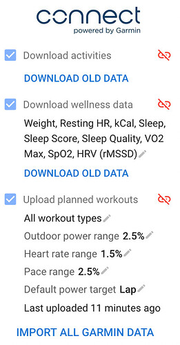

Hi, I’m loving Intervals.icu and want to use it to create and upload my training plan to Garmin (instead of Training Peaks). But the workout that I created for tomorrow (as a test) is not uploading to Garmin. Is there something I’ve done wrong? I’ve attached a screenshot of the workout, and a screenshot of my Garmin settings on intervals.icu. Thanks!

Is your timezone the same in both systems? You can see that in /settings in Intervals.icu and here for GC https://connect.garmin.com/modern/settings.
