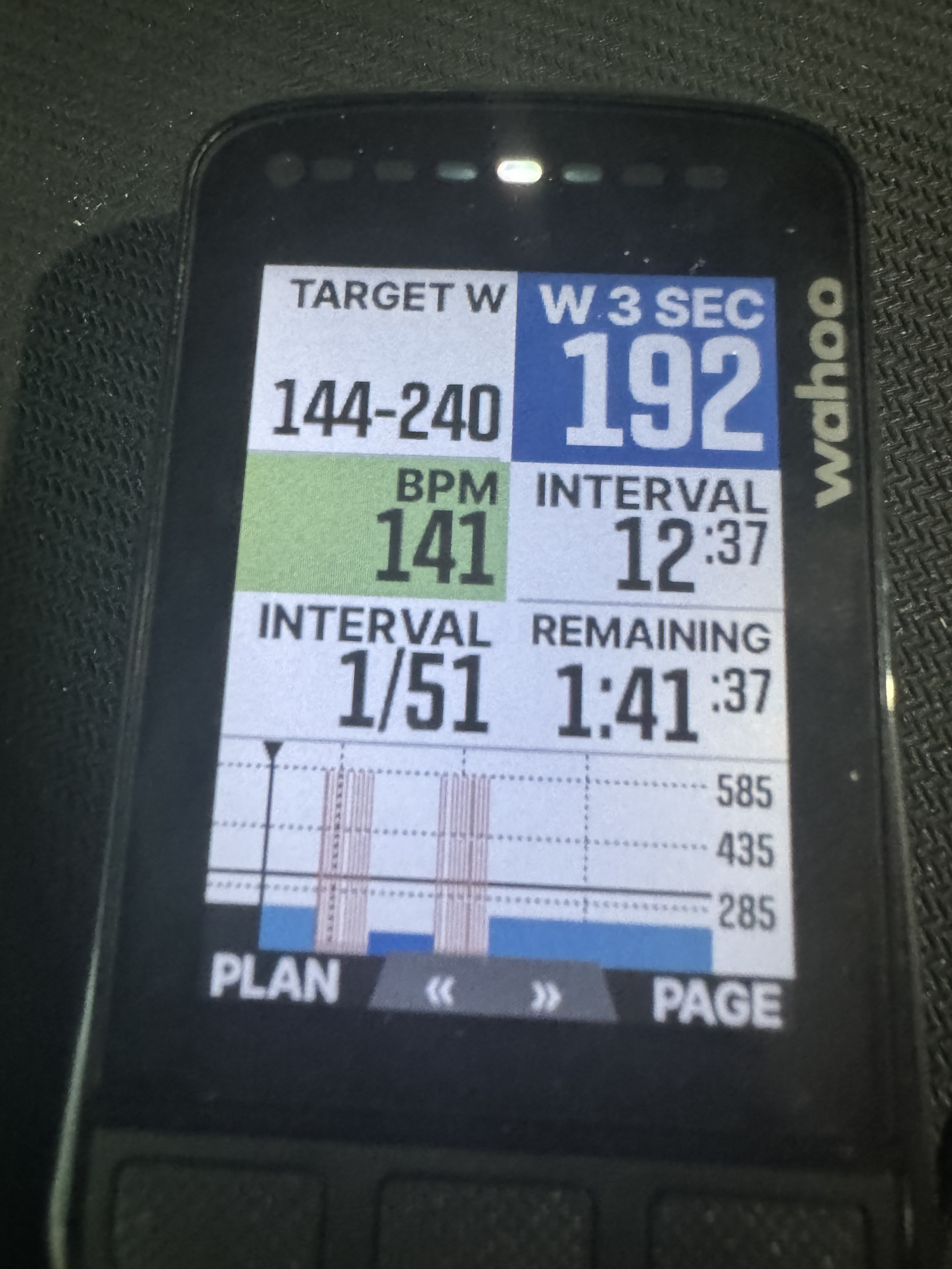

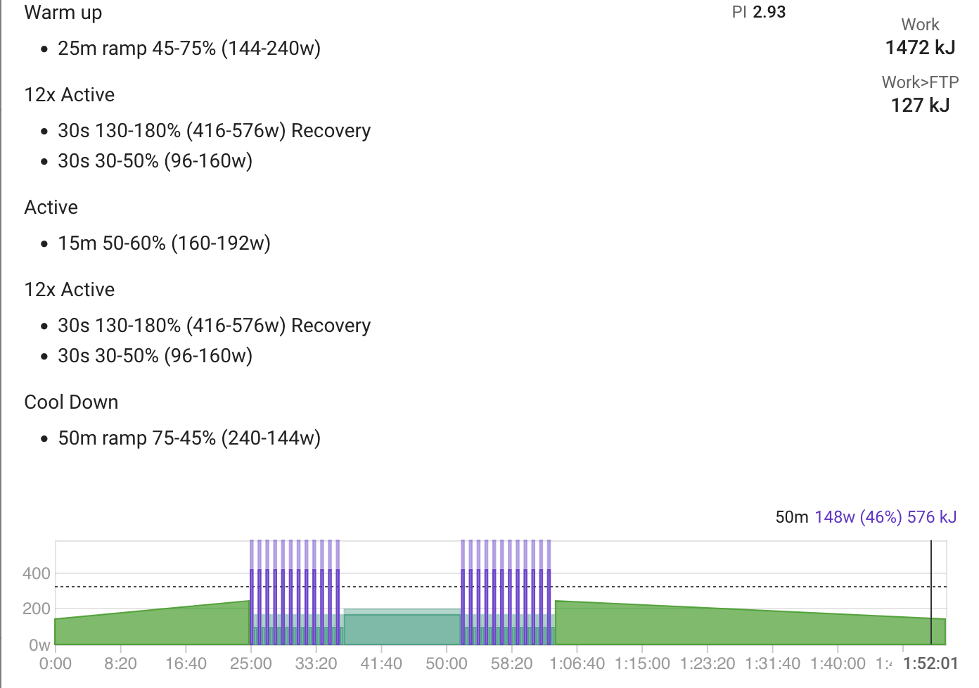

However, it looks to me that ramp intervals don’t upload to the head unit properly. They remain flat intervals with the target power being the average of the ramp up. Not sure if this is an issue with how I crafted the workout, intervals.icu’s upload, or on Wahoo’s end.
This is my workout in intervals.icu:
And this is how my workout looks on my head unit.
I’m pretty sure it’s not supported by wahoo units. TP doesn’t do it either, and they’re all wahoo cared about for years.
