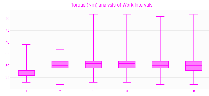

I added Torque (Nm) analysis to the list; @MedTechCD you may want to double check that it’s correct. :wink:
Great diagram, thank you! Could you make it for W/kg, too? It would be great to discuss group-rides with group members: the individual watts are less relevant in that context, but rather the “normalized effort” (on a rolling terrain), which is the W/kg
