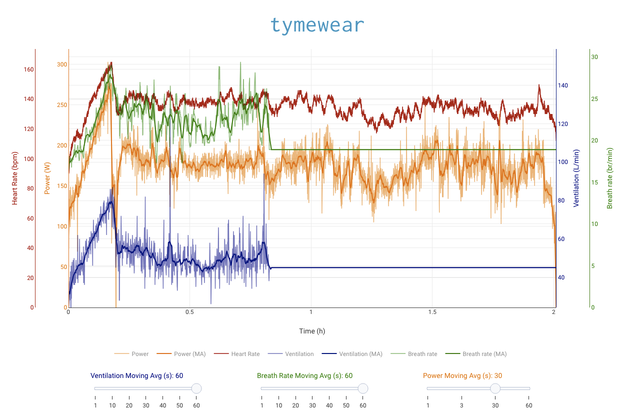

The strap, generally, works fine, but even there some precautions and adjustments are necessary, i.e., how to wear it – wearing under base layer (under bib straps), which is a must in cold-weather rides for me, is not so straightforward. Following the last firmware upgrade (causality or only correlation unknown) the strap stopped working 30–45 min into the workout. Got an extra firmware update from support right the next day, but that still had the same problem yesterday. Assume I’ll get a new update today and hope it will fix the issue😉

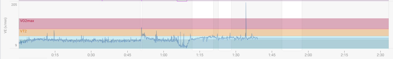

i’ve also had the breathing sensor stop sending data during a handful of rides and have contacted support but have not received a response. before the latest firmware, i had zero issues with the strap. my work-around has been to remove/replace the battery before the session, which then resets the “battery usage” back to 100%, which is less than idea.
