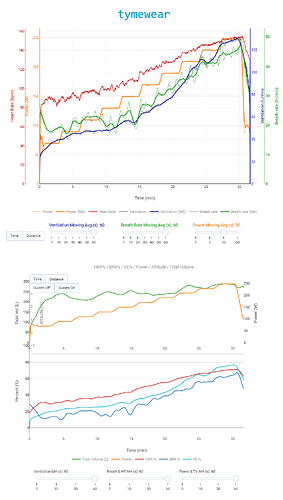

I did my first Tymewear Test on the bike today & so am posting my charts if anyone is interested. I am still waiting for the official Tymewear analysis which will likely be 2 days with it being a weekend. I did ask Coach Watts to have a look & so it might be interesting to compare his finding when the official Tymewear result comes through. I have got the tail end of a chest infection & so will need to repeat the test once full recovered.
This is the Gemini analysis using @Timur prompt
As an academic sports physiologist, I have reviewed the high-resolution ventilatory time-series data from the Tymewear FIT file and the accompanying dashboard visualization. The following analysis focuses on identifying your physiological thresholds (VT1, BP, VT2) and assessing your metabolic efficiency and ventilatory reserve.

I’m on my phone at the moment and not had chance to read through everything but to my untrained eye VT1 @ 15m and VT2 @ 20m ?
I agree with VT1 around 15m, but VT2 is all but ‘easily’ identifiable. I would even think that VT2 has not been reached… or maybe just when the ramp was aborted.
All things taken into account, if VT2 was around 20m, then HR should plateau, which is not the case.
I see that too, but nothing beats doing a lactate threshold test to calibrate, as recommended by Timur

Looking at your graph, VT1/LT1 is most likely around the 15-minute mark, between 145-150 watts. From my perspective, that should be the top of Zone 2.
It is harder for me to clearly identify VT2 here (which is surprising, as VT2 is usually more distinct). In this case, I would prefer to be conservative and place VT2 somewhere around 21-22 minutes, which corresponds to approximately 200-210 watts.
It will be interesting to see what the Tyme calculations show.
