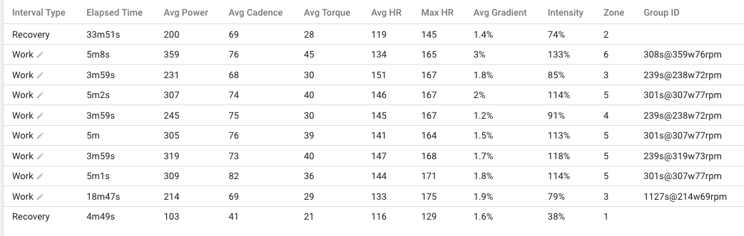

So I did a 4x5 minute intervals today, trying to keep over 300w. Looking at my power meter readout, I had no trouble with that. Looking at Strava, my power over the 4 intervals were 349w, 322w, 337w, 346w. Okay, that seems fine.
With the data imported to Intervals, I selected ‘Use Laps’, and the laps show up, but the data looks very different. Indeed, it looks like the intervals are shifted in such a way that there are a lot of zeros in the data.
If we look at the data in the Interval Data tab, we see this:
Which is pretty suspect, because lap 3 was a rest lap. According to Strava, my average power for that lap was 46w, which checks out because I was mostly rolling downhill and trying to rest.
Strava also says my first lap was 36:26, but in that table, my first lap is only 33:51, which is a pretty significant drift.
Is there a problem with using the lap data specifically? I’ve resynced the data from Strava to be sure, but definitely once I select ‘Use Laps’ it all goes a bit sideways.
Edit: If I manually clip the intervals from the start of the power to the end, the calculated values come out to the same as Strava’s, so it’s just the alignment of the imported lap data that appears to be wrong.
