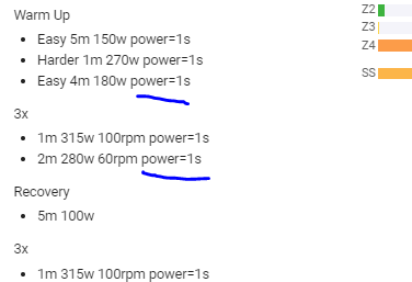

I’m not 100% sure but did you set the power to 1s when you built the workout ??

no, non l’ho mai scritto e non sapevo bisognasse scriverlo.
Quindi ad ogni step scrivere power=1 s?

The fit file is generated using settings from the selected athlete to resolve %FTP and zones and so on if that helps.
The power=1s says steps should target instant power. The default otherwise is average power for the lap.
Comunque ho provato a scrivere anche così e niente, la potenza rimane sempre a 0 su garmin 530
