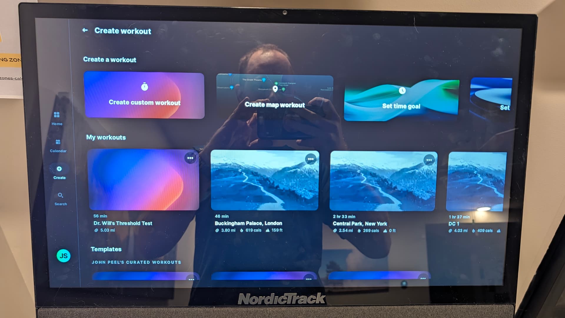

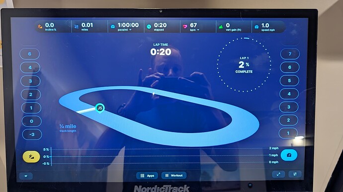

If you have any information how to make this work with the NordicTrack ones, I am all ears. I have the Commercial 2450. I have tried everything so far, I can only make very basic custom workouts using the touchscreen right now, which is a major pain and doesn’t utilize my heart rate to adjust anything.
First of all share a picture of the ifit manual workout window on the treadmill so I can address it
Is this ths screen you are looking for?
Or one of these screens?
