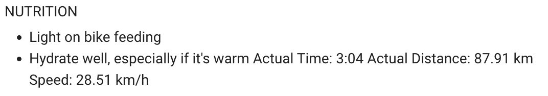

I checked out older calendar events, they seem to have the same format as current ones. Everyone has Planned Time, Actual Time, Actual Distance, Speed in my case.
I’m not sure is it related or not, in the calendar event I have:
\n\nNUTRITION\
 n- Light on bike feeding\n- Hydrate well\, especially if it's warm\nPlanne
 d Time: 3:00\nActual Time: 3:04\nActual Distance: 87.91 km\nSpeed: 28.51 k
 m/h\n
On Intervals though there is no Planned Time in workout description.
This is related to the new distance steps in workouts feature.
I put in a fix to strip out the “Actual Distance: …” bit and it seems to be working now.
