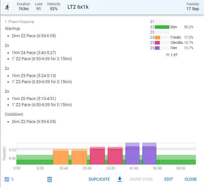

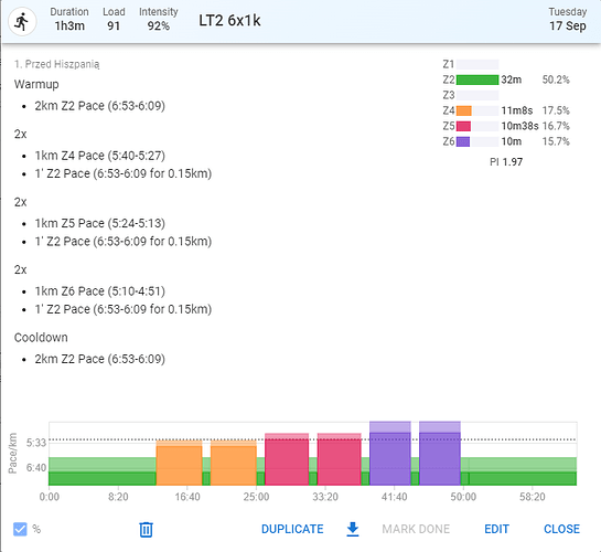

Hi All!
I’ve recently found out how to set up training plans and did that for myself.
One of the run workouts I have is like this:
Warmup
  • 2km Z2 Pace (6:53-6:09)
2x
  • 1km Z4 Pace (5:40-5:27)
  • 1’ Z2 Pace (6:53-6:09 for 0.15km)
2x
  • 1km Z5 Pace (5:24-5:13)
2x
  • 1km Z6 Pace (5:10-4:51)
Cooldown
I’ve wanted to base this plan on pace and run length.
I’ve also set up my training zones to what Garmin told me about my threshhold: 168HR and pace 5:30/km. Yesterday I did this workout and my Garmin estimated my LTpace to 5:24/km so I’ve changed my settings here as well. Sadly my completed workout got updated (didn’t click on “update activities”). The workout above is AFTER I made the change. Before the times were couple seconds slower per km.

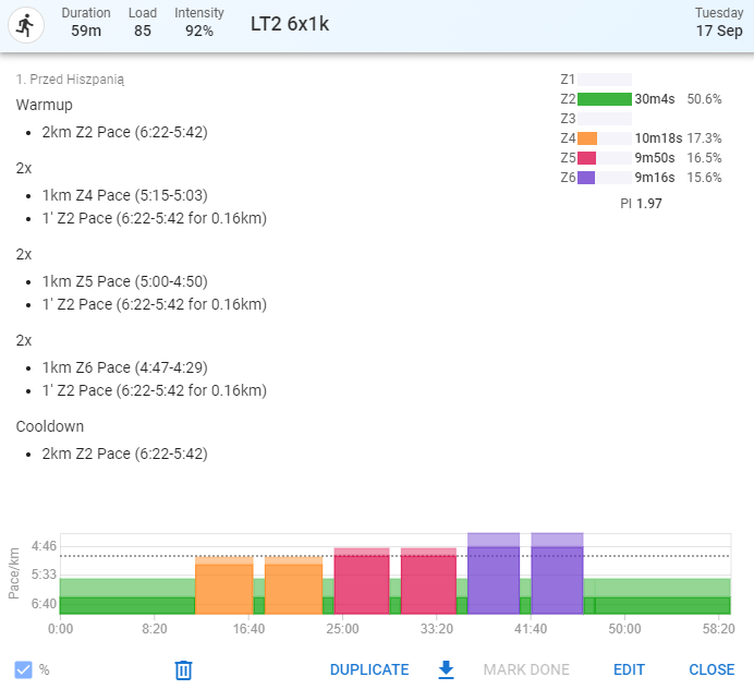

The past activites are not updated - that’s true. But I have issue with past planned workouts - I’ve just changed my LT pace from 5:24 to 5:00 and my prescribed workout for yesterday changed from the above to:
Warmup
  • 2km Z2 Pace (6:22-5:42)
2x
  • 1km Z4 Pace (5:15-5:03)
  • 1’ Z2 Pace (6:22-5:42 for 0.16km)
2x
  • 1km Z5 Pace (5:00-4:50)
2x
  • 1km Z6 Pace (4:47-4:29)
Cooldown
Is there a way to lock in place this somehow?

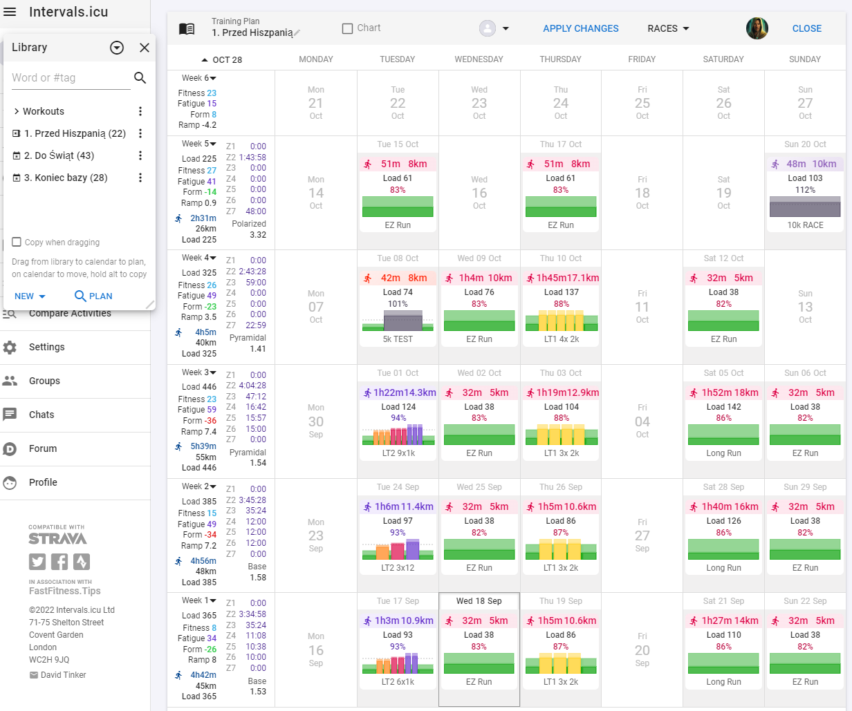

Plan overview:
This week and next one:

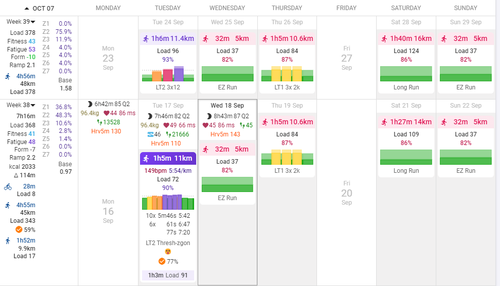

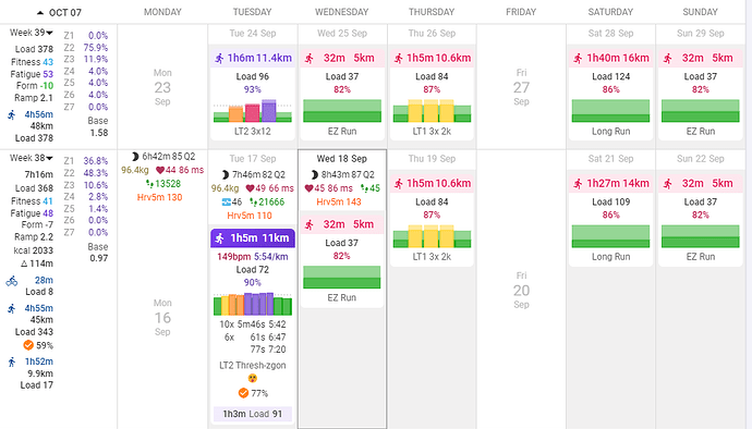

Yesterday’s workout at 5:24:
Yesterday’s workout at 5:00:
