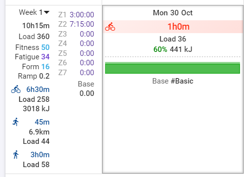

this is the view in the training plan:
pretty much the summary of the planned training

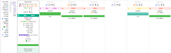

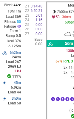

And this is the view in the actual calendar after today’s training (1h easy cycling):
It looks as if the completed training is somehow mixed with the planned.
e.g.: total hours, training load, zone distribution.
not sure on whether or not this makes sense. I would have expected to see the numbers of the completed training, as in the calendar view without a plan, and alongside a comparison to the plan.

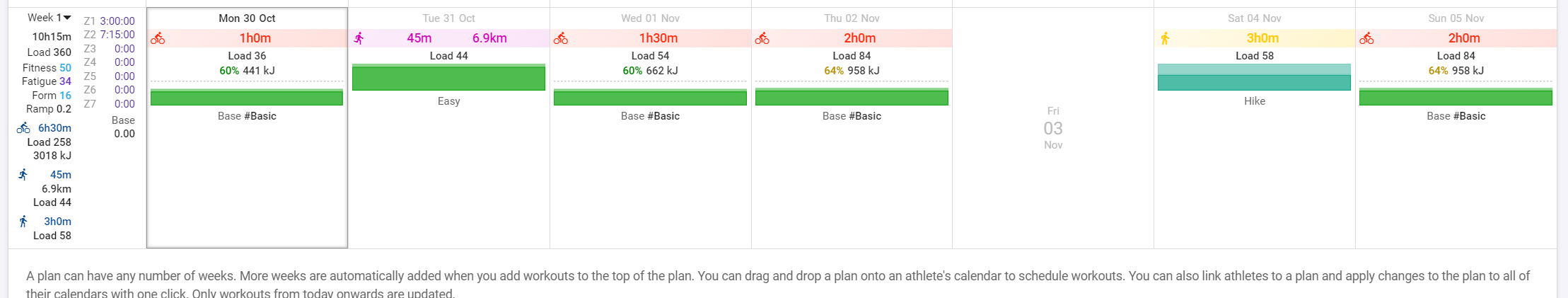

It would be easier to assist if you show the full week plan.
sorry, sure.

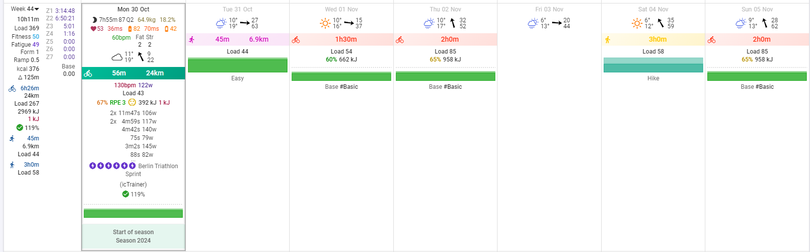

and the calendar incl. todays training
It shows the total planned for the week assuming you are going to complete the workouts. Planned workouts in the past don’t count. As soon as you do an activity on a day, matching planned workouts don’t count.
The compliance number in the week summary view shows how well you are tracking against plan so far using training load (if available) or time otherwise.
