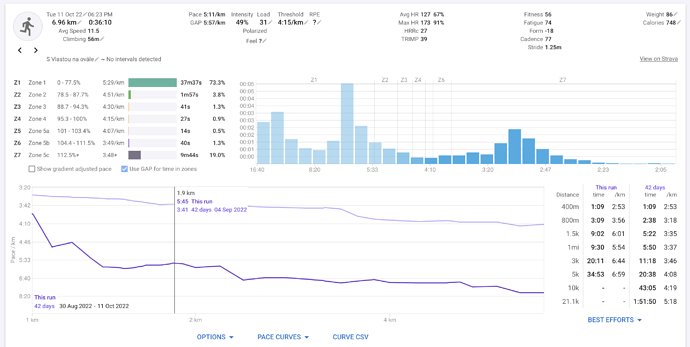

I would use pace histogram (which is already available) and calculate TSS score for each segment (pace range) of it and then sum all to get the result.

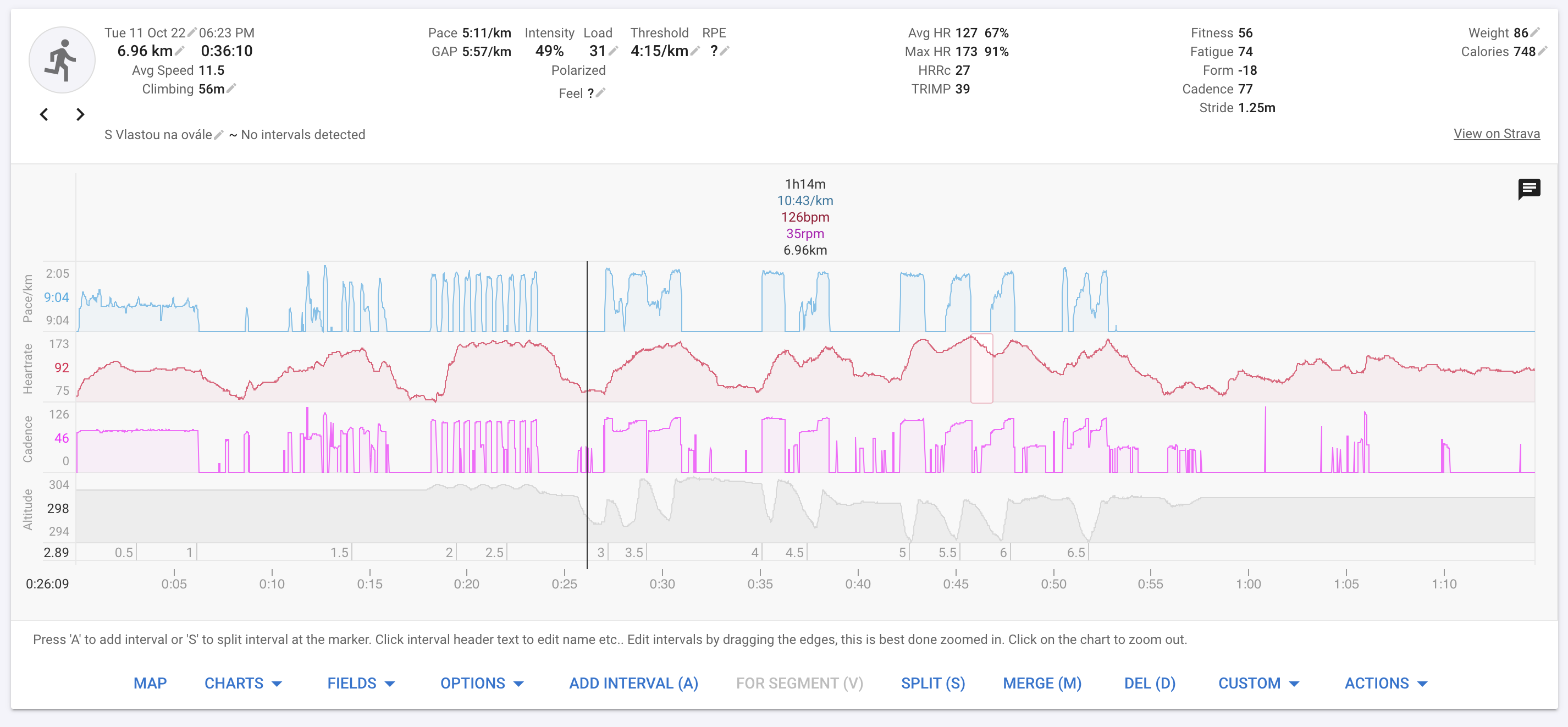

This might be my example interval session:
HR based TL is 30 (My max HR is 195)
Pace based TL as is currently computed is 31 (My threshold pace is 4:15/km)
Pace-histogram based TL is 58.5
