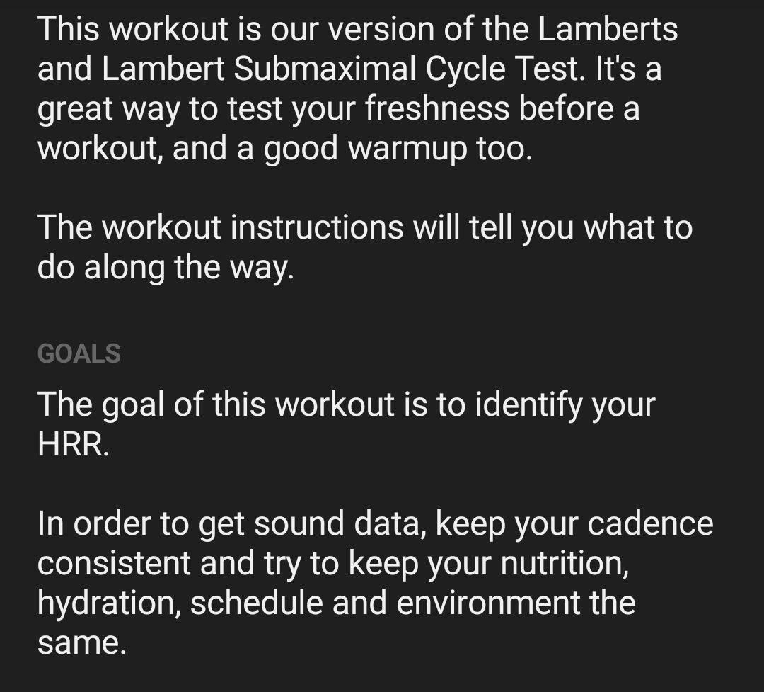

There is a workout on TrainerRoad called LSCT Warmup which attempts to do this.

I like to use HRR or LSCT during my warmup to look for signs of fatigue.

The Lamberts and Lambert Submaximal Cycle Test (LSCT) is very similar but adds other parameters (http://www.scienceandcycling.com/lsct/basic-interpretation-lsct/). Personally I like to do the LSCT as a warm up before a moderate or high intensity workout. If I find signs of fatigue I will postpone the moderate/high intensity workout and do some low intensity training. Or you could use something like this paper (https://pubmed.ncbi.nlm.nih.gov/31490431/)
If you want to check HRR at lower intensities I would say a good starting point is 70-75% of max HR. The problem is that a faster HRR could be present on f-OR or on a athlete that has an improved training status and you need the RPE information to differentiate between these situations. One parameter that works really well for me is not being able to quickly reach 90% of my max HR on the third stage of the LSCT. If that happens I know it is time to rest.
