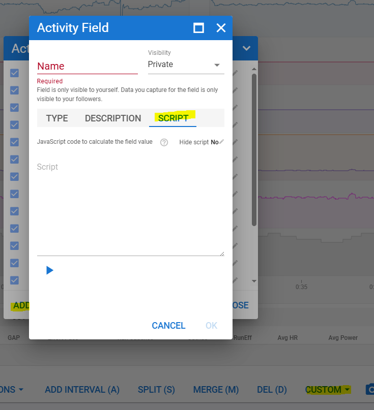

Thanks … I’m not quite following how you implement this. Where are you running this code? I’ve spent a fair bit of time putting together python scripts to pull all my cycling activities, filter them, calculate these metrics, and then add them to the activities. But in the process, I discovered that there’s not way to access any of my cycling activities because they all come from strava and so are not accessible through the API. So now I’m completely at a loss.
You can code quit a bit within Intervals itself. On the bottom af the activity timeline tab, there is a menu ‘Custom’, which has the possibility of adding custom fields coded and calculated by yourself. Enter your JavaScript there to create your own Custom fields per activity. Then you can use those custom fileds to plot on the Fitness page.
very cool! if I create a script within one activity, can I have it apply to all activities?
Yes, it will executed for every new activity automatically. If you want to run it with older activities, go to the activity list and select all your old activities and then Edit → Analyze
