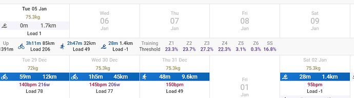

TR Swim Workouts missing under "Fitness" but showing in calender
Hey,
When I plan a Triathlon Plan in Trainerroad with swim, bike and run it will sync correctly to the intervals calendar and show the correct description and duration. It will also display correctly in the totals of the calendar week. However i cannot see it in the “Fitness” View under the “Swim Bike Run Hours” plot. Is this a bug from the import or on the intervals backend?

I have just fixed this. Workouts without training load were being left off the chart. Tx.

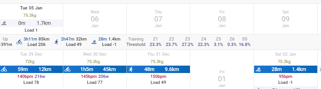

Is there any issue with the Swim workouts? Is this happening to someone else? The time in the pool is zero and the load is very low. I do have my Swim FTP in my settings. Everything is okay in Garmin Connect and Strava. When this was only strava never had an issue in swim or open water swim

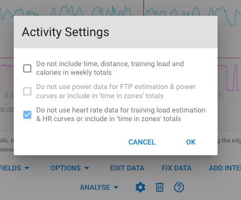

That swim has HR data which is used for the load calc. However it is mostly zero (looks like as soon as you got in the pool) so not helpful. I have changed the code to ignore the HR data for load calc and hence use swim FTP if the ignore HR box has been ticked (click the cog icon under the ride timeline chart). Will deploy TM.

Thanks for the solution, looks a great idea because normally the HR in the water is far away from real.
This is great, would it be possible to allow for retroactively updating some or all previous swims to use the swim FTP for loading calculation?
It’s not so easy to do that especially since it looks like yours have real HR data. Is swim FTP better for load even if real HR data is available? If so I need to add a setting to always use it for swims, even those with HR data.

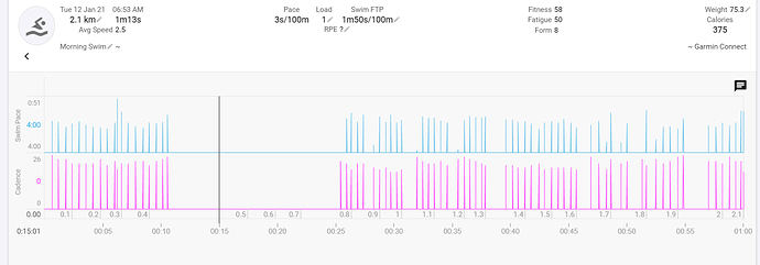

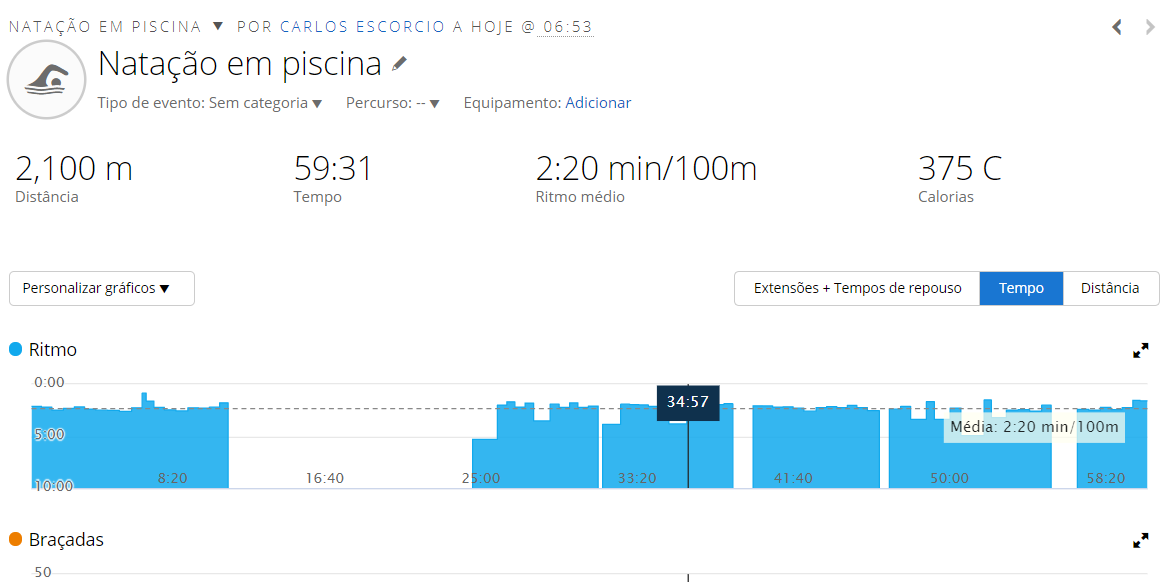

This is in Garmin

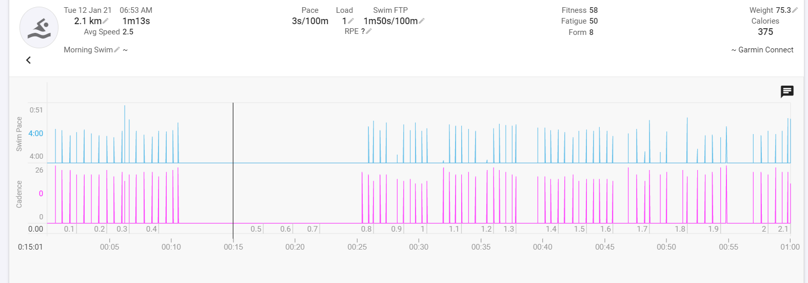

But in intervals.icu i get this and the pace and load is way wrong.
Is there any setting i can change?
I have fixed this and will deploy Wed AM (GMT+2). Your .fit file had an extra set of records, one for each length that was causing some trouble.
