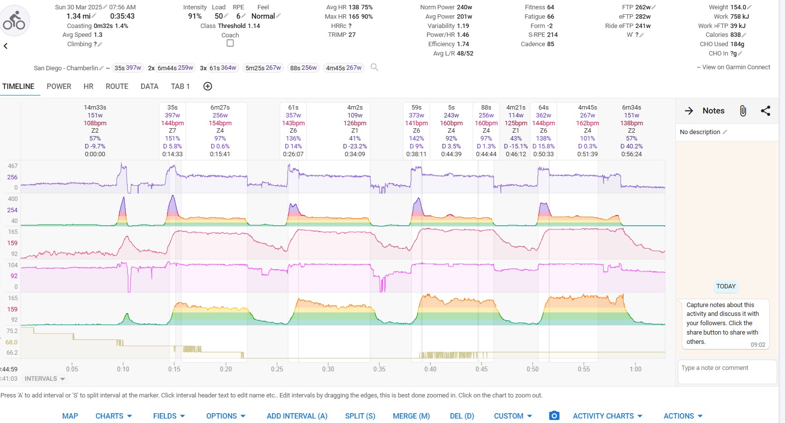

I have a similar issue that just happened. Normally, I complete my session outdoors, but this weekend I did an hour session indoors. My activity is complete in my garming, but when synced to intervals it only adds up some of the intervals and reduced that activity time. Any ideas on how I could fix this?
intervals has a ride time of 0:35:43, but actual ride time is 1:01:49.
Pretty sure that you forgot to turn off GPS.

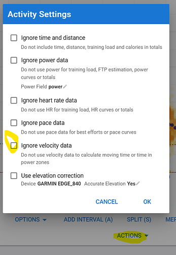

Actions - Settings, ignore speed/distance would solve that.
Thanks @MedTechCD . I will try that on my next indoor session.

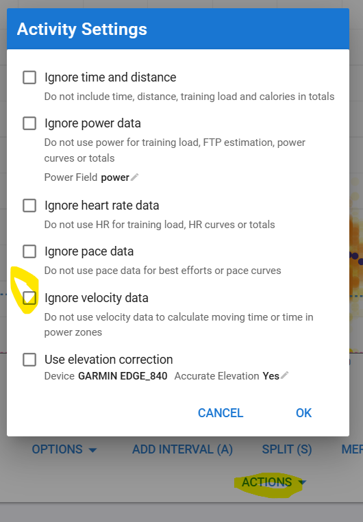

You can solve it now by going to Actions - Settings - Ignore Velocity data (not speed/distance as I said above…)
It should immediately take effect without the need to re-analyse.
