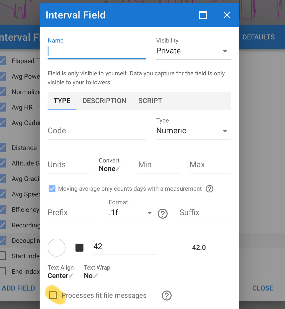

Did you tick the process fit file message box? Because it should process fit files.
If you share a fit file example, I could take a look.
Yes, but that doesn’t provide an option to choose the FIT file field to use.
In custom activity fields that box doesn’t need to be checked to choose the FIT file field.

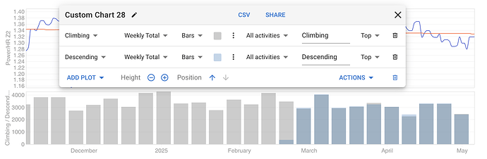

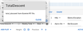

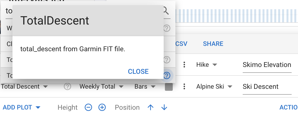

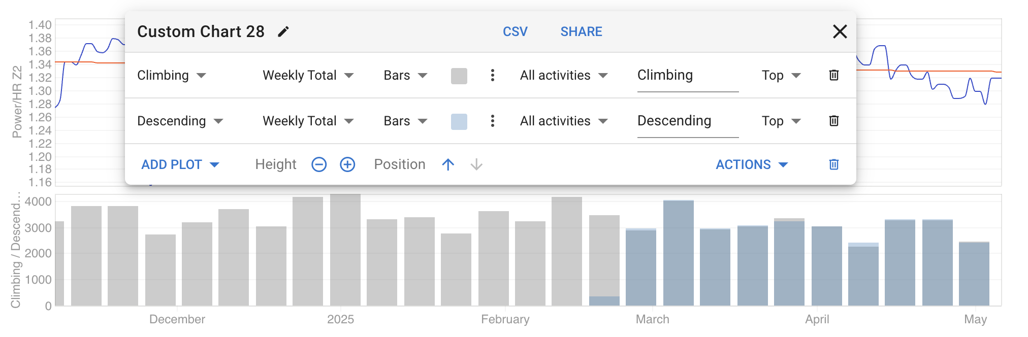

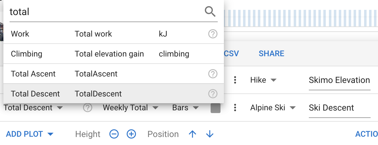

In the fitness timeline it’s possible to create a custom chart and set it to monthly and/or weekly plots.
I have added this to the /fitness page plots:
Note that the feature was added at the end of Feb. For activities received by Intervals.icu before that you need to do “Reprocess File” to get descending.
