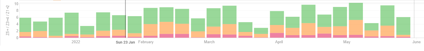

So in this graph you can see my 3 levels training on weeks, i think i may ended up doing too much Z3 (out of 7 levels), but im not sure. What do you guys think?

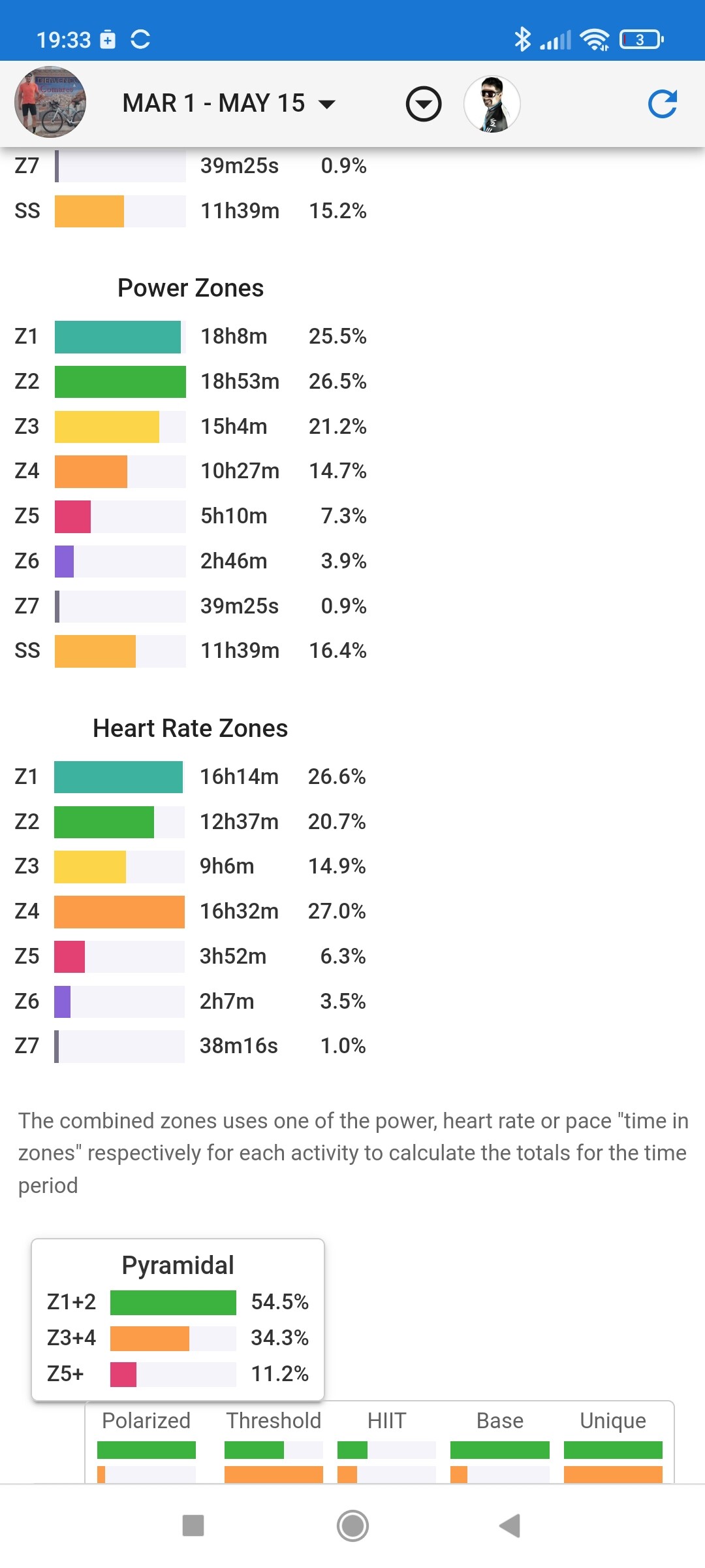

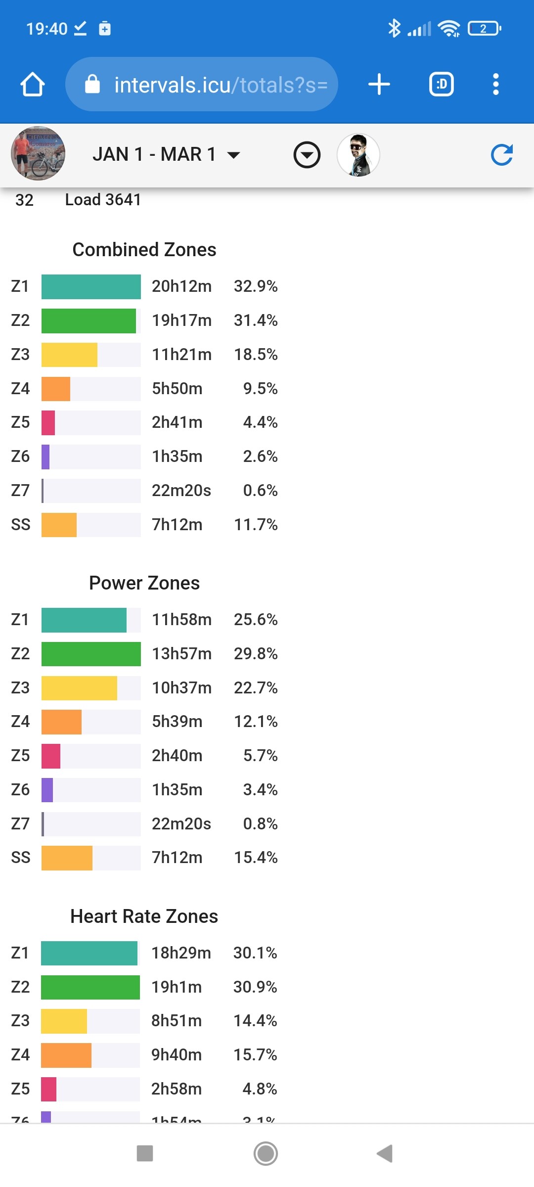

Perhaps you could share your totals page, that shows the time in zone. Like this one:

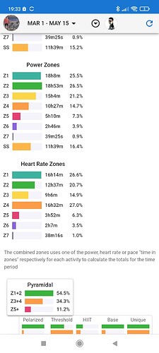

This two images, one of them from beginning of year till now. Other from 1 march to 15th may.
You have power and heart zones there @Gerald
I guess most of my z1 riding is downhill or coasting

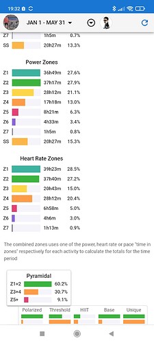

This one 1st january till 1st march
Heart rate can get quite messy because the heart doesn’t freewheel; it passes through the levels (zones) on the way up, and back down again during the work periods.
Your base work might not have been perfect, but it certainly wasn’t a waste. You’ve admitted it’s too much tempo, but I can promise you that there are world class coaches out there that do a similar amount of tempo work, in their base programs (for the recreational cyclists they coach). The only difference I can guess, is that the long ride on a Saturday/Sunday is all endurance or lower intensities and the amount of rest/recovery.

I havent done intervals at Z4 other than a few longer climbs (there arent many here). I just think i should have done more structured sessions at ftp intervals instead of doing a lot of z3 and all out (z5+) efforts on short climbs. And probably should have done a lot more of z2.
I somehow ended up in a not so hard efforts and not pure endurance either
