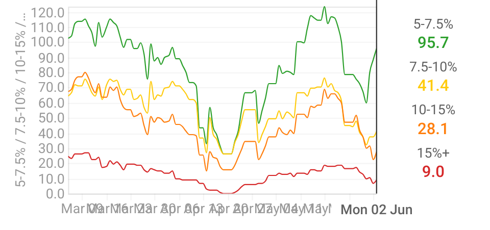

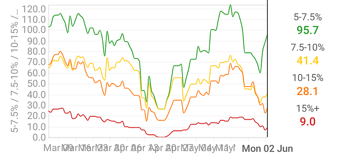

Thanks David! I think this will work for now. Long-term, a % of total to standardize fluctuation in ride-time would make this better, but this will do just fine for now! Here’s a view I created as inspiration (trailing 7 day totals)
