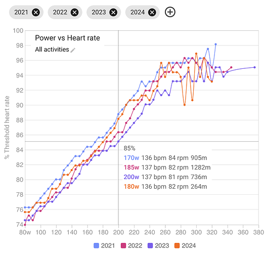

Over the years I formed the opinion that in the context of training, HR is only useful when
a) referenced to power and observing trends. Here is a long range trend over 4 years:
3 years of consistent training averaging around 7-8 hours/week for each year, and easily see improvement in HR for power around upper zone2. Then I focused on strength and conditioning and allowed cycling fitness to drop. Pretty easy to see the changes.
b) doing easy rides well under that top of HR-zone2 from above, which I determined by changes in breathing around 135-137bpm so its really something like vt1 with lt1 being below that. And by easy, I mean under 10bpm so keeping average HR under 128bpm no matter what zone power is in (often around 40-55%).

If over longer periods, you see higher and higher power numbers at the same HR, it means you are doing more external work with the same internal effort, thus getting fitter. Point a) above.

My opinion is to pick one, train by power and use HR as guardrails. Even if that means using larger power ranges like I do (easy endurance 40-60% ftp, which happens to be roughly 70-80% LTHR). Increases in fitness are measured by power, not HR, as your HR at lt1 and max aerobic steady state are relatively fixed.
